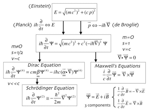

The Maxwell wavefunction of a photon is given in [here] as follows:
Because the curl operation mixes 3 different components, this wavefunction only works for a minimum of 3 space dimensions, with each grid point having 6 component numbers ##{E^1, E^2, E^3, B^1, B^2, B^3}##, and with the following update rules:

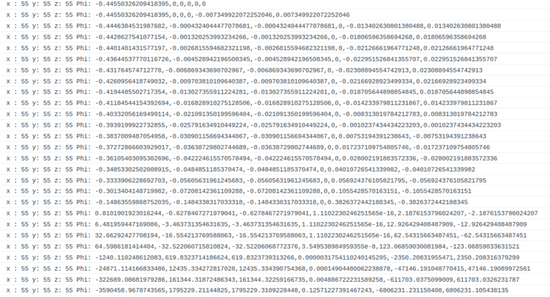

Setting Ei = ##sin (\frac{i}{width}2\pi) ## for all the 6 components:
still produces no time evolution! The curl operation is rather finicky.
4.
Setting E1 = ##sin (\frac{x+y+z}{width}2\pi) ## and ## E2, E3, E4, E5, E6 = 0 ## everywhere:
finally produces a time evolution.
However the time evolution explodes partway, as shown in the chart, and the numerical data below.
I am unsure why this happens, because the update rules involve only additions (with no multiplications or other fancy operations)?

I have my doubts about the maxwell wavefunction of the photon idea, but for Maxwell’s equations just from poking around the web, people seem to use FDTD (also called Yee’s method) for the discretization which staggers E and H in time and space.
Likes James1238765

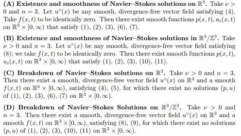

6. The Millennium Problem description for Navier Stokes seems to be about analytic solutions to the equations and their properties:
