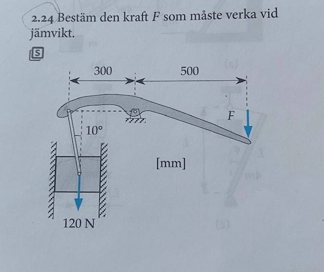

I have a homework problem and it goes like this.
What does the force F need to be in order to achieve equilibrium? (look at picture for more details)
Could someone help me with this?

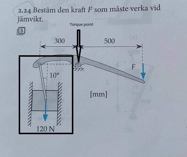

In PF things go like so: you post your problem statement and your attempt at solution and you indicate where you are stuck. Then we try to help with hints and questions.
In this case: what have you learned that could help you with this problem ? Principles, formulas etc.

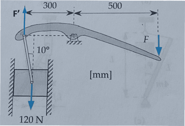

Well i learned about torque and to achieve equilibrium it has to be the same on the left of the torque point and to the right.
My problem with this question is i don't know how to deal with
I know what to do on the right.
Torque RIGHT = 500 * F
but the rest i am confused about
How big must F' on the left be to compensate for the weight of 120 N ?
It had to be equal to 120 or am i wrong here?
OMG i can not believe i had trouble with this :H i solved it now thank you!
You are welcome.
(But you solved it yourself ! Well done! :smile:)
