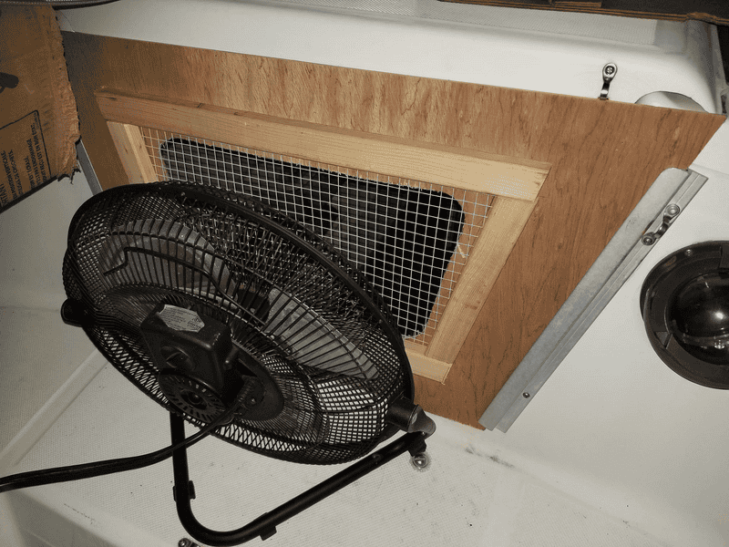

Yes, he has a fan in the companionway of his boat, so blowing into or out of the boat itself.
The fan sits about six inches in front of a 1.5 foot square hole in a panel in his companionway.
I concluded that, even more than the direction if air flow, something that would help is to duct the fan - put a cowl around it, so that air is forced though the boat, rather than just wasting a lot of energy circulating air outside. Yes?
Yes.

Sorry all, I could have posted this right up front for your reference. This is from the poster:
This was my suggestion as to his best, simplest option:

DaveC426913 said:
Yeah, that sortta what I was thinking, which is why I asked here. I think the best possible thing he can do is duct the fan.
Yes, but even that may not be necessary for a well built fiberglass boat. The important thing is to get all of the water out. Drain ALL of the bilge water, remove any sponge-like wet stuff (carpet, foam, etc.), keep more water from getting in, and provide a bit of airflow.
