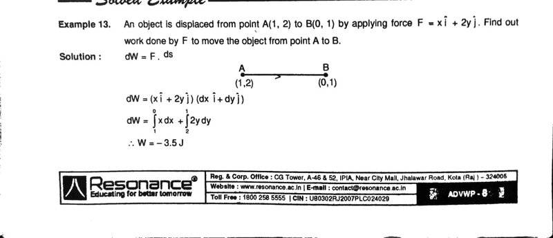

Here's a better one. In addition , my doubt is with both the integrals
Something seems strange to me. How does a particle move from A to B by applying ##\vec F##, which always points in the opposite directions in which it needs to travel. To me it seems like some other force is moving the particle from A to B and ##\vec F## is resisting it?

Note that the diagram is misleading. The usual convention is that the +x direction is to the right, and the +y direction is up. So the displacement vector AB should be drawn pointing down and to the left (225º w.r.t. the +x-axis).
(Alternatively, AB could be as drawn but with the xy axes suitably rotated.)
We use 'dx' rather than '-dx' because the direction of movement is taken into account by the integration limits. Note that for example ##\int_a^b f(x)dx = -\int_b^a f(x)dx##.
The sign of the x-contribution to work is determined by the initial and final values of x. Similarly for y.

You have a choice in these cases. You can use ##dx## and have the integral go from 1 to 0. Or, you can use ##-dx## and have the integral go from 0 to 1. You get the same answer either way.
Note that the work done is negative, which highlights that the particle was not accelerated from rest between these two points. It must have had an initial velocity in a direction roughly opposite the force. We can let @erobz figure out what it must have been!

I get that. Please see the problem statement:
An object is displaced from point A(1,2,) to B(0,1) by applying force ## \vec F = x \boldsymbol i + 2y \boldsymbol j ##

The work done is negative because the direction of the force is opposite to the displacement, in both the ##x## and ##y## directions. So, however you set up the integral you must get a negative answer. You can do that in two ways.
Alternatively, change your coordinate system so that the displacement is in the positive x and y directions, if you don't like negative displacements.

Start with:
$$ dW = ( x ~\hat{\text{i}} +2y ~\hat{\text{j}} ) \cdot ( -dx ~\hat{\text{i}} -dy ~\hat{\text{j}} ) $$

This is wrong. ##dx## and ##dy## relate to your coordinate system. Not to any given displacement.
Your argument is like saying that if ##x = -1##, then you need to use ##-x##. The differentials ##dx## and ##dy## can be positive or negative.
PS they represent the change in ##x##, whether positive or negative. It's the same for the finite ##\Delta x##. This is the change in ##x## whether positive or negative.
Likes scottdave and erobz
If you integrate ##x## from 0 to 1, then ##dx## is positive. If you integrate from 1 to 0, then ##dx## is negative. And vice versa for ##-dx##.

It has to do with how you compute the dot product. In the other thread, you used ##\vec E \cdot d\vec r = \lvert \vec E \rvert \lvert d\vec r \rvert \cos \theta##. Both ##\lvert \vec E \rvert## and ##\lvert d\vec r \rvert## are, by definition, positive quantities. Since you were integrating along a path in the radial direction, you had ##d\vec r = dr\,\hat r##. It followed that ##\lvert d\vec r \rvert = \lvert dr \rvert##. If ##dr<0## (determined by the limits of the integral), then ##\lvert dr \rvert = -dr##. If ##dr>0##, then you replace ##\lvert dr\rvert## with ##+dr##. You're not throwing in signs willy nilly. You put in the minus sign because of the basic definition of the absolute value.
In this problem, you're calculating the dot product using the components of the two vectors. There are no absolute values present. Since ##\vec r## is defined as ##\vec r = x \,\hat i + y\,\hat j##, it follows that ##d\vec r = dx\,\hat i + dy\,\hat j##. The signs automatically work themselves out.
