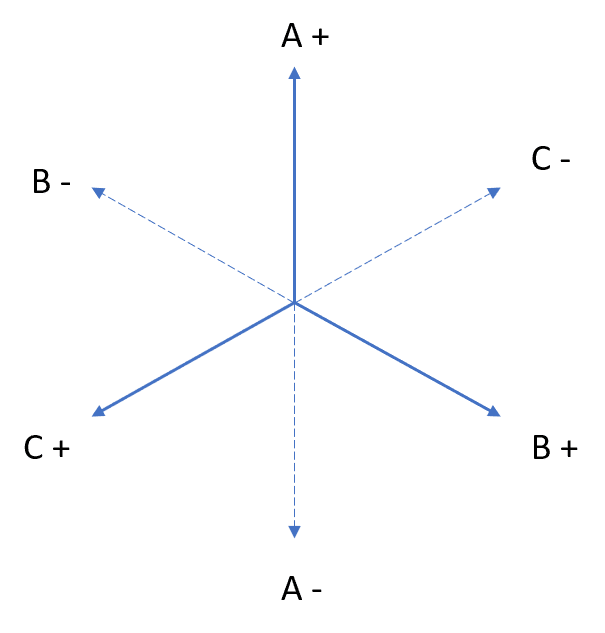

Hello, I have read and watch some informative videos on bell's inequality. I think I understood it but as I go deep more questions arises.
First I give detail of what I think I understood so far.

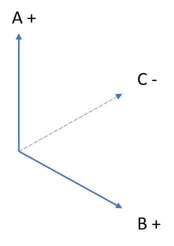

Suppose, there are three angles A, B, C separated by 120° angles. A can measure + (spin up in A direction, we call it A+), and - (spin down in A direction, we call it A-). Same goes for B+, B- and C+, C-.
I have choose A direction to measure +, B to measure + and C to measure -. So this way my equation looks like below.
P(A+, B+) ≤ P(A+, C-) + P(C-, B+)
I could find that this stays true if hidden variables theory are correct and it violates when quantum mechanics is correct using probability as below.
P(X, Y) = cos2(xy)/2)
Is my understanding correct so far? Specially the equation I wrote is correct? I need to understand more but I want to confirm that from where I started is correct or not.
Thanks.
The point is that we are talking about two measurements of spin/polarization, each on one particle in an entangled pair. So that: $$P(A+, B+)$$ is the probability that the first particle is measured in the A direction and the result is +; and, the second particle is measured in the B direction and the result is +.
Does that make sense?
