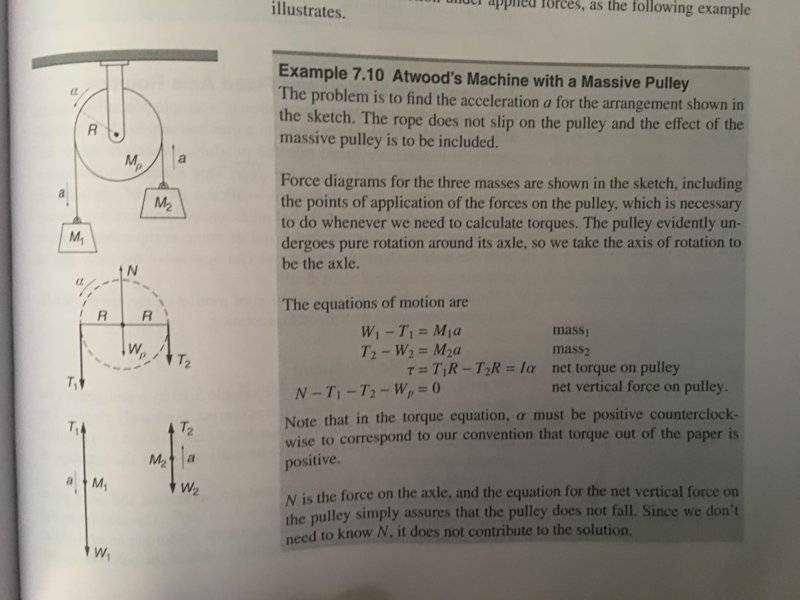

As it relates to the pulley image, can we agree that choosing our origin to be in a different plane would most certainly change our calculations? Is my way of thinking correct?: In this scenario, not only is the origin simply in the same plane as the pulley center of mass, but the origin is chosen as the center of mass. This eliminates the need to worry about an orbital angular momentum component which makes this problem (or similar problems where this approach is taken) easier to solve. Drawing and solving our problem in this 2-D manner is then encouraged.
If we chose our origin to be on this axis of rotation but not on the center of mass or not on this axis of rotation at all, we would get a more complex 3-D or 2-D (if the origin is still in the same plane as the center of mass) where we would then have to be concerned with an angular momentum component. (Although, however, in this specific pulley scenario, it seems that the orbital component will still be zero as the center of mass velocity of the pulley is constrained to be zero.)
The calculations, but not the answer.
I feel you are looking for a theorem that says all choices will lead to the same answer, therefore choose the most convenient.
Indeed, that can be proved. You might care to attempt it yourself.

Oh, that the net torque summed about any and all origins is the same if the net force on the system is zero? I didn't think of referencing that. So, if my thinking is correct, this determines that the time-derivative of the angular momentum vector of the pulley analyzed about any origin leads to the same answer. In this pulley scenario, for an origin not at the center of mass, an orbital angular momentum component may be introduced but it will equal zero (as the velocity of the pulley's center of mass is zero), allowing us to simplify our equation as the time-derivative of only the spin angular momentum vector which will be found to be the same about any origin.
The same answer to the underlying problem, yes. (Obviously not the same answer for the torque about the axis if a different axis is being chosen.)
E.g. for the pulley, if we were to choose an axis off to one side of its mass centre then we would have to include the torque due to the force supporting the pulley's axle. We know that force will balance the gravitational force on the pulley and the tensions in the rope, so we can write down what this torque is in terms of those. When the dust clears, the horizontal offset of the chosen axis cancels out and we are back to the original equation.
