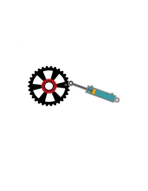

Please disregard this post if this forum is only academia related. This is a real word physics question.
I work in a hydraulic cylinder repair shop. I have a hydraulic machine that can tighten and loosen bolts and nuts with a lot of torque. When tightening, it is important to know how many foot/pounds of torque was used.
Here is how the machine works. A hydraulic ram pushes on the circumference of a cog that has a socket in the center. The hydraulic ram has a 4” diameter piston. So the surface area of the piston is about 13 square inches.
Assuming the ram is pushed with 100 PSI of force, what is the torque delivered to the socket? Does the cog provide additional torque, similar to a lever? Does the angle of the ram engaging with the cog affect the torque? What additional information do you need to provide an accurate answer?
Here is a crude diagram pieced together from clip art. Hopefully it helps to illustrate the problem.

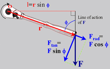

Welcome, TBC!
Do you have a way to use a torque instrument?
Assuming the pressure will not be good, you will need to measure it.
The torque on the nut or bolt will be greater as the distance between the shaft and the center line of the cylinder increases.
Please, see:
https://www.grc.nasa.gov/www/k-12/airplane/torque.html

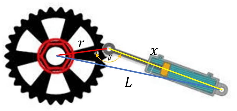

The triangle I have drawn in here is going to a piece of the puzzle. Can you relate all the variables using trigonometry "Law of Cosines"?
After you get the relationship, there are a few trig identities to apply to find the torque as a function of ##x##. I'll explain the relevant stuff with forces/torques you need to understand along the way.
Keep in mind...I don't know what level of math you are comfortable with... but a "precise" mathematical model requires some knowledge. If you are looking for conceptual, we can help with that too.
If you show honest engagement but can't do the math, I'll give you a formula in the end to play around with.

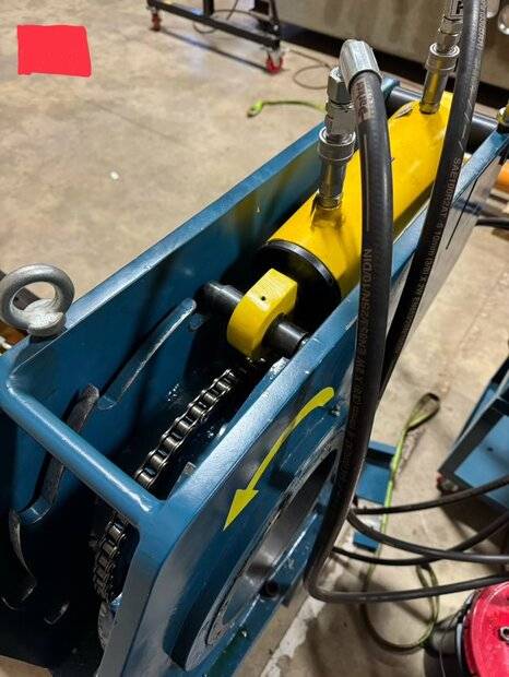

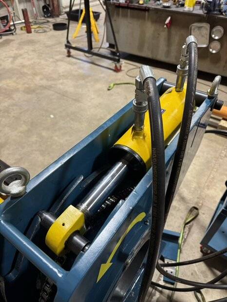

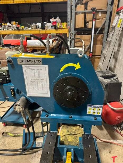

Here are the pictures and some additional information. The cylinder stroke is 6 inches. It takes 12 strokes to turn the drum 360 degrees, which is 30 degrees per stroke. At the beginning of the stroke the angle of the cog to the gears on the drum is about 6 degrees. At the end of the stroke it is 4 degrees. My goal is to be able to tighten bolts and nuts to a specific torque specification by applying the appropriate PSI of hydraulic pressure. Hopefully this helps.
*NOTE* Images were too big. Working on that.

The rod doesn't engage the pawls until its extended about an inch from what I can tell in the picture-5 inch stroke? If you have drawings of the machine that would be better, its going to be challenging to get accurate measurements of the components assembled as far as I can see. We might be able to infer ##L## and ##r## if your angular measurements of 6 and 4 degrees, and stroke are accurate.
I was thinking the same thing about getting measurements. I don’t have any drawings. I will reach out to the vendor to see if they will send any. In the meantime, I will try to get the best measurements I can. To get the angle of the ram, I used a digital inclination meter.

From the diagram with the triangle, where is the torque variable? What is the formula to determine the torque given the variables listed?
You have to find the cosine of the angle ##\beta## as a function of ##x##, then the torque ends up being ##\tau = rF\sin\beta##
Is that chain linked to the hydraulic motor?
If so, what those two do?
My guess is that it is a chuck for the nut.
Yes, once the ram breaks the nut or bolt loose, the hydraulic motor can remove a lot faster (decent rpm). It sacrifices power for speed. It does not play a part in the question.
It would be very helpful if you provide an example. I really don’t understand the formula you provided.
Let’s say r=16”, beta=6 degrees, I’m lost after that. Sorry, as you can see math is not my strong suit.
##\beta## isn't 6 degrees, it's going to be more in the vicinity of 90 degrees. ##\beta## is the angle between the force and the radial line from the point of contact to the axis of rotation. It quite literally needs to be the angle in the drawing for the formula to work, not just any of them. The force of the cylinder is ##F## and it's directed along the rod.
But I believe you, so I'm not going to bore you with the details of eliminating it mathematically:
$$ \tau = r F \sqrt{ 1- \frac{(L^2-(r^2+x^2))^2}{4r^2x^2} } $$
having the correct ##r## and ##L## are critical to this, and they will be difficult to measure directly on the assembled machine.
I can do some more algebra, and tell you what they could be ( given some reasonable measurement errors ) if you share what angle measures relative to what are 6 and 4 degrees - relative to what exactly.
This is the torque that is being applied to the nut ( from this mechanism - ideally) when this system is in static equilibrium. Meaning, before the nut breaks loose.
If you are really after the tightening spec, I think it would also be the torque a "torque wrench" should measure if everything was moving very slowly, without jerking and the force was constant from the hydraulic cylinder (measure pressure accurately).

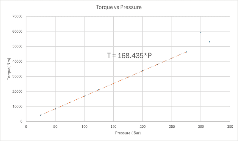

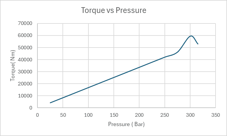

Currently, I use a table of pressure (measured in BAR, not PSI) provided by the vendor of the hydraulic tear down bench. Some torque specs are lower than listed, or are between the values. I need to be able to calculate the amount of hydraulic pressure needed to be able to tighten to any given torque requirement. I have no idea if the information they provided is correct, so I wanted to verify. I’ve included the table below. They use the metric system. Have no idea why the last pressure entry only increased by 15 when all the others were 25.
Table
Pressure (BAR) Torque (NM)
25 4210.87
50 8421.74
75 12632.60
100 16843.47
125 21054.34
150 25265.21
175 29476.07
200 33686.94
225 37897.81
250 42108.68
275 46319.54
300 59530.41
315 53056.93

Well, if they are giving you table of values they probably tested it. I would stick to the table.
Here is a graph:
The wobbly bit at the end is a bit funny, and likely won't be explained by the equation I gave. Thats experimental. Also, excel is "filling in the blanks" with high order polynomials, so you would need some more data out there to be sure about that. The good news is most of the graph seems linear.

Was this chart generated from the data table I provided? If so, the point I made was that I have no idea if the data is correct and wanted to verify.
Yeah, it was. I was trying to help you by giving you a formula for the data so you wouldn't have trouble in between values. Is the value at 300 correct, or a typo?
This equation is good for data up to 275 Bar. I just excluded the points at the end. The point at 315 looks like it would fall in line, which is why I asked if the data at 300 was a typo.

I'd guess the maximum operating pressure for the equipment is 315 bar, so the final value in the table is 315 bar rather than 325 bar.
  • #32
Thats fine, but you are going to need precise/accurate measurements of the variables before you can do that. We have to be critical of the model that comes from pure mathematics over what was experimentally measured by the company which designs and manufactures it. There may be "hidden variables" that are difficult to pin down theoretically that would show up experimentally. It's not so easy. Do you suspect a miscalibration, why?
  • #33
I don’t suspect a mis-calibration. It’s just that torque specs are important. A loose bolt or nut can cause severe equipment damage. Just trying to make sure I limit my liability.
  • #34
Good guess. I just checked and the maximum pressure of the hydraulic pump is 300 bar.
  • #35
Regarding that table entry for 300 Bar.
It appears to be a transcription error by whoever supplied the table. The rest of the table is completly linear.
As for the 300 Bar entry, if the "9" is changed to "0", then all the digits match as 3 times the 100 Bar value and 6 times the 50 Bar value.
Except for the last digit, it also matchs as 12 times the 25 Bar value which is likely a round-off error in the 25 Bar value.
Likes SammyS and Lnewqban
  • #36
The torque at 300 bar is given as 59530.41 Nm. It appears that the '9' should be a '0', i.e. the value should be 50530.41 Nm.
This puts the 300 bar point exactly on the straight line formed by the other points.
Incidentally (I don't think anyone has said it yet) giving the torque values to 7 significant figures leaves something to be desired!.
  • #37
Does anyone else suspect the table not to be actual measured data. It's too perfect (other than the expected typo)?
  • #38
Yes. Almost certainly.
Maybe the values are calculated from the accurately known dimensions (which was what the OP originally wanted to do).
Or maybe the values are based on actual measurements and the best-fit straight line was found. Then the table could be constructed using the gradient of the best-fit line.
