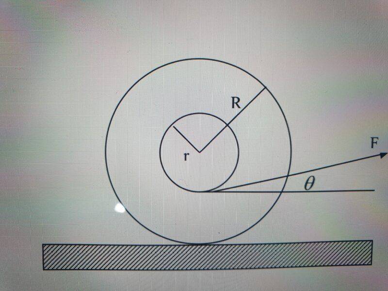

Hello,
i have tried to calculate the acceleration (COM) of the cylinder (even though in the question they asked about the angular acceleration) and the answer is:
𝑎(𝑐𝑜𝑚)=𝐹(𝑟/𝑅−𝑐𝑜𝑠(𝑡ℎ𝑒𝑡𝑎))/(𝐼/𝑅2+𝑀)
and my answer is with minus (I/R^2 - M) . in their solution they wrote in the torque equation--> f(static)R-Fr=Ia(Com)/R but i don't understand why , because the magnitude of a(com) is positive ( chose the right direction as positive) and f(static)-Fr is <0 so why take f(s)R-Fr and not like i did Fr-f(s)R=I(a(com)/R
(at b))
why isn't obvious that the cylinder will roll rightward?
thanks for the help
https://ibb.co/QPYKG3p https://ibb.co/MMTzRtS

hi thanks for your help,this is the question:
the system in the picture is placed on a floor with friction. the cord that wrapped around the inner cylinder is pulled by force F with angle theta
the system is rolling without slipping on the plane.
the system moment of inertia is given by I and is of mass M
1.what is the acceleration of the system
2.what is the direction of the movement
here the cylinder is rotate counterclockwise and the rolls to right
so that is why i took Fr-f(s)R=Ia(com)
but the answer is when you do the opposite f(s)R-Fr=Ia(com) and i don't understand why.

maxhell said:
Homework Statement:: Torque and rolling
Relevant Equations:: Torque=Ia and F=ma
Even if ##\theta=\pi/2##?
Do you mean that those are the directions you are taking as positive? Clearly it cannot actually rotate counterclockwise but move right.
Which direction are you taking as positive for the frictional force?
Disagree! (Also, I'd call it a yo-yo or a spool, to distinguish it from a simple cylinder.)
If the yo-yo moves to the right wihtout slipping (rolls), then it must rotate clockwise, not counterclockwise. (In this case the string will get wound onto the inner part of the yo-yo, which is a bit counterintuitive.)
Watch this demo':
Thnks for the video i understand now that i was wrong and the torque of friction is bigger than the torque of the force.
And when the angle is 90 degree than the friction is the only force in the x-axis and it will roll to left and than the troque of the tenstion is bigger than the torque of friction. right ?
Yes
