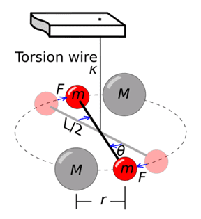

In the Cavendish experiment, the two small balls have mass m each and are connected by a light rigid rod with length L. The two large balls have mass M each and are separated by the same distance L. The torsion constant of the torsion wire is κ.
b) Put the large balls a small distance away from the small balls, when the system reaches the equilibrium, the rigid rod rotates an angle θ and the distance between the centers of balls is r, as shown in the above figure. Find the expression for the gravitational constant G.
c)If the small balls are perturbed with small angle from the equilibrium position in (b), will the oscillation be harmonic? If so, find the expression for the period of the oscillation.
∑τ = Iα
T = 2π/ω
I solved for part b. But I can't get the answer to part c.
Part b: G = 2π2Lr2θ/(MT2)

Let the new angle be θ1
∑τ = Iα
GMmL/(r-0.5θcosθ1)2 - κθ1 = Iα
α = 2GM/(L(r-0.5θcosθ1)2) - 2κθ1/(mL2)
I can't make α=-ω2θ1 to find for ω to solve for T.
Isn't "r" a function of L and θ?

Originally when it is in equilibrium, the distance between M and m is r. Then the small balls are perturbed with small angle from the equilibrium position, so the new distance between M and m is r-0.5θcosθ.
That's not how I interpret the diagram which clearly shows r depending on the angle θ.
The distance between M and m at equilibrium when θ=0° is r=L/√2.

In part b it says it rotates at an angle θ when it reaches equilibrium. Then in part c it says the small balls are perturbed with small angle from the equilibrium position in part b. So in part c, the new angle isn't it θ+small angle, which we call it θ1. I'll edit my θ in my workings to θ1. I think it's confusing to use the same θ.
OK, I see that now.
This expression is not correct:
r-0.5θcosθ1
For one thing the dimensions are wrong.
Since θ1 is a small angle then a good approximation for the distance between M and m would be:
r' = r-Lθ1
Now you are squaring this number r'. How much different will r2 be from r'2?

Why is it Lθ and not θL/2? Since the radius is L/2.
Yes, you're right, L/2.
So the new torque would be:
2GMm/(r-0.5Lθ1)2(L/2) - κθ1 = Iα

The net torque may be written $$\tau = \frac{A}{r^2} - \kappa \theta = \frac{A}{(r_0- b\, \delta \theta)^2} - \kappa (\theta_0 +\delta \theta) $$ where ##A## and ##b## are constants.
##r_0## and ##\theta_0## are the equilibrium values of ##r## and ##\theta##, and ##\delta \theta## represents displacement of ##\theta## from equilibrium.
For small ##\delta \theta## you can linearize this expression to get ##\tau = -B \, \delta \theta## for some constant ##B##.
You're right, we forgot the original Kθ term. That will simplify the equation down to:
GMm/r2 + K(θ+θ1) = Iθ1''
(GMm/r2 + Kθ) + Kθ1 = Iθ1''
1 = Iθ1''

Okay, but I have a problem. I do not know how to linearize it for the fact that δθ is small. What is the trick here? I mean a lot of the post here tells me to 'simplify it' but I just don't know how to get started. I know (r0 - bδθ)2 ≈ r0 right?
  • #31
Yoonique said:
Okay, but I have a problem. I do not know how to linearize it for the fact that δθ is small. I know (r0 - bδθ)2 ≈ r0 right?
That's going too far in the approximation.
For ##\frac{1}{(r_0-b \, \delta \theta)^2}##, use the binomial approximation: http://en.wikipedia.org/wiki/Binomial_approximation

Okay I got (GMmL/2)(r0-2 + Lδθr0-3) - κ(θ0+δθ). How can I simplify even further?
  • #35
I don't get the 2 in the numerator of the first factor.
To simplify further, think about the condition that holds at equilbrium.
