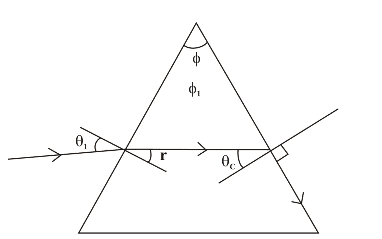

In summary, the homework statement is trying to find the lowest angle of θ1 given the apex angle is 60°. They state that r = ϕ + θc and how to find r. However, they are not seeing it correctly and need a diagram or something to help them.
ParoXsitiC
58
Find the lowest angle of θ1 given the apex angle is 60°. Air (n=1) is on the outside and inside (n=1.5)
ϕ is defined as 60 degrees.
θc = sin-1([itex]\frac{1.00}{1.50}[/itex]) = 41.81°
To my understanding, θ1 must angle in such a way to make r (the angle of refraction) to be equal to the critical angle. At this point you will start having TIR.
How? I am not seeing it.
Once I found r, I can just use snells law to find θ1 - but I don't understand how to find r.

Need some sort of diagram so the position of this θ1 is knows.
I give one but perhaps its not showing for you since its minus.com, here it is on imgur
Image came through that time.
If you look at the top triangle - the one with the 60o angle, the other two angles are (90 - r)o and (90 - θc)o
That means [(90-r) + ϕ + (90-θc)] = 180
so 180 -r + ϕ - θc = 180
or -r + ϕ - θc = 0 which means r = ϕ - θc
Notice that is slightly different to what was in your original solution. I suspect something was wrong.
