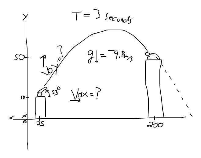

In Summary, the projectile is fired from a cannon at a fixed angle (53 degrees) and at a distance of 25 meters. After 3 seconds, it hits its mark at different heights 50 meters above the ground and at a range of 175 meters.
jambraun
A projectile is fired from a cannon at X-distance of 25m (X=25), height 10m (y=10), and fixed angle (53-degrees). After 3 seconds, the projectile hits its mark at different height 50m (y=50), and at a range of 175m (X=200). Gravity is normal and there is no wind resistance.
What is the original velocity of the projectile, required equations to find the original velocity, and the equation showing the position of the projectile at any value of 'Time'.
Gravity = -9.8m/s
Starting X = 25m
Range (X to target) = 175m
Firing Angle = 53-degrees
Starting height (Y) = 10m
Target/End height (Y) = 50m
Time in air = 3s
Unknowns = Velocity(original X), Velocity (original Y)
I'm looking to apply this to a game I'm programming but haven't been able to make headway on the equations for months now. I've come close with an example from Khan (https://www.khanacademy.org/science...launching-and-landing-on-different-elevations) and a few others but I can't seem to re-write the equations to solve for initial velocity, and then the proper equation to find the position of the projectile at any value of 't' (time), but I think that's a standard equation once I find the original velocity. Any help is much appreciated!

Your situation violates the laws of physics. The laws of physics establish a relationship between the free fall acceleration, height, range, time, and launch angle. The numbers you state don't fit that relationship. You have to abandon anyone of those five values because each is determined by the other four.

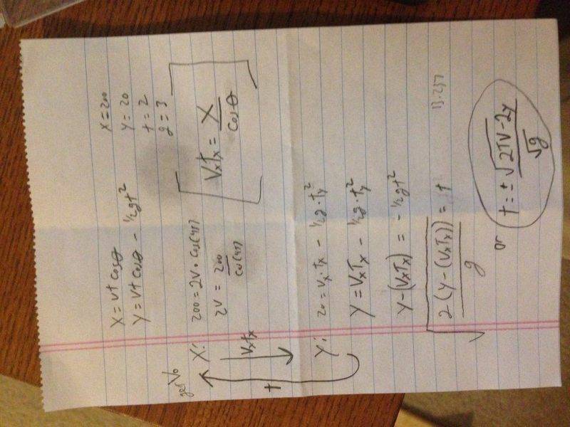

Thanks CWatters, my major notes are in my notebook at home; I'll post them in the morning. I think my primary issue is displacement of X to compensate for the differing heights. I have no problem calculating the launch and land from the same altitude which is pretty straight forward.

I knew something was up...I can be flexible on time or gravity. let me post the equations I've been working with in the morning but I still think my hangup is with the height displacement. Thanks!

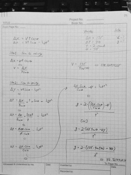

We'll still have to talk about how to account for displacement I think. Here's what I was trying to use:
3 step process and 2 primary equations for determining initial velocity:
Primary Equations
X=v*t*cos(theta)
Y=v*t*cos(theta) - .5*g*t^2
Step 1 (create a substitution for Y from the equation for X):
Initial Velocity of X * Time = vt = x/cos(theta)
Step 2 (plug equations from X into Y in order to isolate t):
Isolating time from the equation for Y
== Y = VxTx - .5gt^2
=== Y-(VxTx)=-.5gt^2
== t = SQRT((2(Y-(VxTx)))/g)
== t = (SQRT(2TxVx-2y))/SQRT(g)
Step 3 (plug t back into X in order to find velocity)
X=v*t*cos(theta)
See my notes below from scan. When I used this in a graphing calculator it appeared to come out ok, but it doesn't account for height displacement.

The eqn for y is incorrect. Should be sin(theta) not cos(theta).

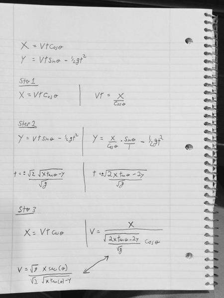

How's this look? More importantly, am I headed in the right direction? Besides the math being correct, is it the correct math to use? I'd be up for using different equations if you know of the correct ones to use to project a flight path that MUST hit a point in space with a few constraints.

How's this look?
The work you did looks correct to me.
Well, let's see. You wanted to alter the value of g so that you could preserve the shorter time of 3 seconds and the rise of 40 m. I showed you how to do that in Post #10. You simply plug all the numbers into that last equation and solve it for g.
##\Delta y=(v_o \sin \theta) t - \frac{1}{2}gt^2##.
Or, you could solve the equation you came up with for g. Either way, you get the same answer. Or you could alter any of the other variables to your liking, provided they are solutions to your equations

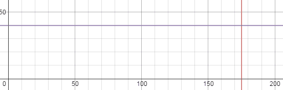

Thanks for the help, btw. I'll try graphing it out in the morning to check the curve.

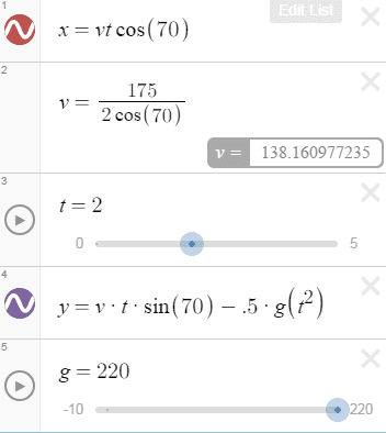

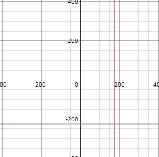

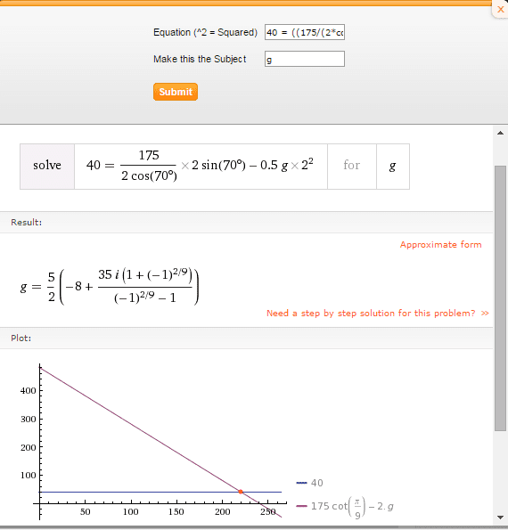

ok, I need someone to check my math... here's what happens when I plug in the variables:
The hardest equation by far is to find gravity (which must be incorrect).
Alternatively, if I solve for gravity by hand...
40 = (175/(2*cos(70)))*2*sin(70)-.5*g*2^2
40 = 212.52-2g...
Help me out where to go from here? I know this answer is MUCH different than the auto-solve.

Your calculator appears to be in radian mode. In your program the computer is treating the angles as if they're expressed in radians, not degrees, so that's giving you an incorrect value for ##v_o##, and messing up the solver results and the plot, too.
Somehow, though, the value for ##g## of 220 m/s² is correct.
By the way, when you change t from 3 s to 2 s, and θ from 53° to 70° it makes the projectile hit the target on the way up instead of on the way down. In fact, if the target doesn't alter the projectile's path it'll take 20 seconds for it to reach the crest! In your Post #1 sketch you show the projectile hitting the target on the way down.

You have different combinations than the OP. He had the angle of 70° for the time of 2 s. And the angle of 53° for the time of 3 s.
Ah ok I used wrong combination of values. If I use..
x = 200-25 = 175m
y = 50-10 = 40m
t = 2
angle = 70
I do get g about 220m/s/s

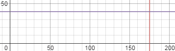

I think that may have done it! Thanks for the help. I'll drop this into my program and see if it hits the target :)
Just so long as you understand that your launch angle is 70 radians, or about 4010°. :H
And as I said before the projectile hits the target while rising. So the trajectory, while actually being a piece of a parabola, might look more like a straight line.
lol, you're absolutely right. Here's the conversion using degrees. I'll have to play with it so the projectile stays on the playfield / looks believable:
All you have to do is go back to the values you were using up until yesterday: 53° and 3 seconds.
