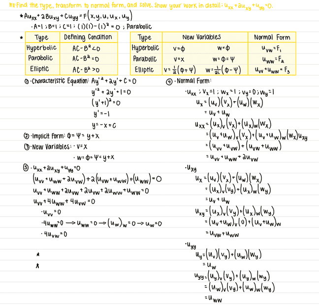

Find the type, transform to normal form and solve. Show your work in detail: Uxx+2Uxy+Uyy=0
Hyperbolic- AC-B^2<0
Parabolic- AC-B^2=0
Elliptic- AC-B^2>0
I don't know how to solve for u(x,y) from where I left of after 5.

Shouldn't you be getting: ##u_{ww}=0##, i.e. ##u(w,v)=Aw+B(v)## where ##B(v)## is a function of ##v## and ##A## is a constant?
The indefinite integral of [itex]0[/itex] with respect to [itex]w[/itex] is an arbitrary function of [itex]v[/itex], not an arbitrary ocnstant.
yes correct then A should be A(v).
