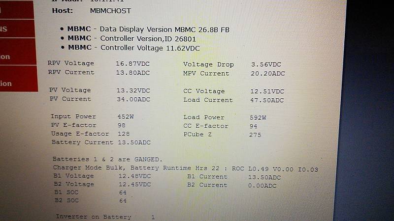

This will demonstrate how run length voltage drop is relative to wiring, current and supply voltage.
I've got two sets (remote RPV Voltage/RPV Current, main MPV Current/PV Voltage) of small solar panel arrays separated by 30 feet of 8 gauge wire feeding a battery pack that's currently running a small AC unit in the shop. The displayed information is from the Web page of my PIC32 controller.
If the line voltages were much higher then the displayed 'Voltage Drop 3.56VDC' won't matter much but it's a nominal 12vdc system so that drop is a high percentage of the supply voltage and a major problem in getting max power from those panels. Lucky for me I've a large run of scrapped 000 copper wire to double up that 8 but I've got to trench 30 feed of dirt to put it in, one day.
