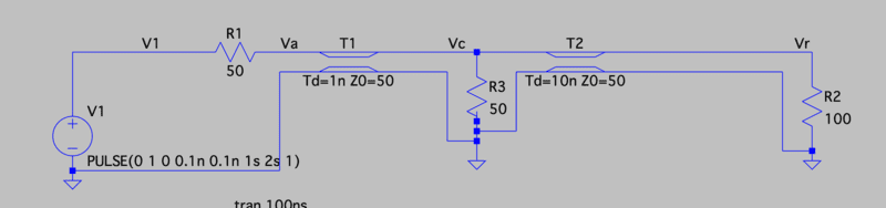

Trying to work out the match for a transmission line with 2x termination.
Like the one here:
https://ibb.co/p4dY7pF
V1=1
R1=R2=T1=T2=50,
V1 sees R1 and T1. So it is divided to half.
Now you have 0.5V source with a 50 Ohms series impedance(T1) looking into a load that is a parallel combo of R3&T2, which is 25 Ohms.
So voltage at load is (0.5*25/75) = 0.16V.
This further reduces to a voltage source of 0.16v with 25 ohm series resistance and 50 ohm Tline?
(not an assignment, just trying to refresh by knowledge)

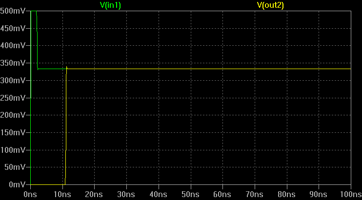

A quick look suggests first simplify the circuit. Since T2 is terminated in a perfect match, T2 can be eliminated and the termination R2, moved to parallel R3, making 25 ohms. Now you have only one line, terminated in Zo/2.
The 1 volt step will appear as a half volt step at entry to T1.
2 ns later, the reflection from the 25 ohm termination will return to the correctly matched T1 input.
You then have a 50 ohm source resistor in series with a 25 ohm load.
So the steady state input to T1 will be 1/3 Vin, as will the output across R2.
Likes dlgoff, DaveE and berkeman
I was trying to figure out the equivalent circuit starting from R3 to the load R2.
Let's say R2=100 and T2=50, then the part from R3 would reduce to
Voltage source of 0.33V with series res of 25 ohm and a T line of 50 ohm?
The 25 doesn't make sense. Since R3=T2, this series res would be 0?
But then what if R3 is not equal to T2.
@berkemen, here's the sim result for ckt earlier.
https://ibb.co/mqmQMrg

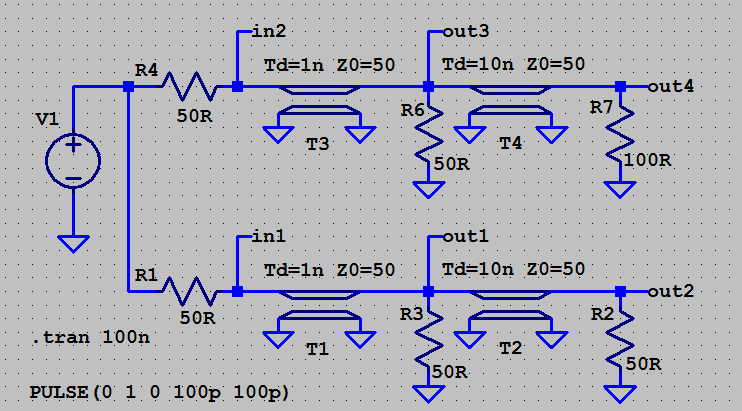

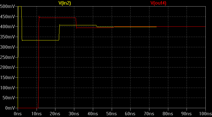

The input to T1 is series matched, so it will not return reflected energy from the T1:T2 junction.
When the terminal load R2 is changed from 50R to 100R, both ends of T2 become mismatched, which makes a resonator.
A transient on T2 will travel forwards and backwards until it settles at the terminal state, or is disturbed again by another transient.
The terminal state will be that of a voltage divider where ( 50R // 100R ) = 33R33; is driven through 50R.
33R33 / ( 33R33 + 50R ) = 0.400 Vin.
