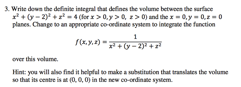

Shown in the photo attached.
2. Homework Equations
V r2Sinθdθdφdr in spherical coordinates
V dxdydz in cartesian coordinates
equation of a sphere x2+y2+z2=r2

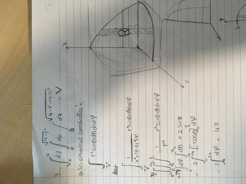

In this case y=(y-2): sphere displaced on the y-axis. and since it is bound by all planes its going to be one quarter of a sphere. I don't get the part where the question says translate the origin to the shape centre, how can I do this? and also I need someone to check my limits of integration. I attached my answer.
Hi,
Can't say I understand your integration limits for the second part. Care to explain ? And where does the factor 2 come from ?
