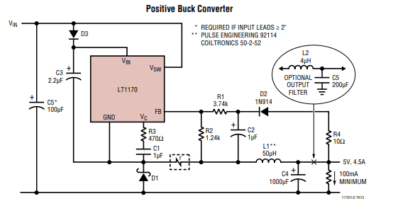

TL;DR Summary: I am trying to change from 25-50 Vin to 5 Vout
Hi, I am trying to use an LT1170 to convert between 25-50 Vin to 5 Vout. Actually, I would like to keep a constant 5 V out regardless of the input. To do that I know the input would have to be 5 V plus any voltage drops with a 100% duty cycle but it's going to be low current so large duty cycles aren't really an issue (I don't think).
I made an LTspice model using the LT1170 from the built in library. I connected everything the same way as shown in the datasheet for a "positive buck converter" but do not get 5 V out. I will mention that a few differences I have are the zener diode and output resistor. Their circuit doesn't define the output resistor since it should regulate the voltage but will just output a higher current. I used 1 Ohm to make things simple. I'm not sure what voltage the zener diode should be rated for because I'm not really sure what it's even doing.
I understand if I can't really get help with LTspice here but even just getting help understanding what the components from the schematic do would be really helpful. Listing all of the components, there is what I think. I tried listing these starting at the left of the circuit and moving right in the order of top to bottom.C5 -- input capacitor to save the source from hard switching.
D3 -- not sure
C3 -- not sure
D1 -- normal buck converter diode (I'm not sure why they show a zener diode though).
C1 -- not sure
R2 -- not sure
R1 -- not sure
C2 -- not sure
D2 -- not sure
L1 -- normal buck converter output filter inductor
C4 -- normal buck converter output filter capacitor
R Unidentified below R4 -- Normal buck converter load resistor
R4 -- not sure
I've attached a screenshot of my LTspice schematic and the output current and voltage waveform at "out" and through "Rload". The link to the datasheet is below. I've also attached a screenshot from page 15 of the "positive buck converter" that I'm trying to build.

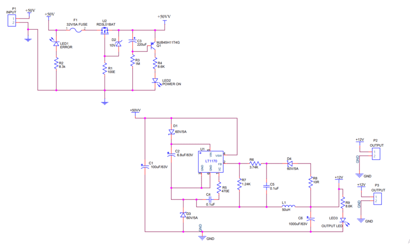

Hii i have design PCB Board and i have solder components i have given input Vin=32V and Vout= 12V but i am getting Vout= 29V. Please check any changes in my schematic.

At a quick glance, it looks to be wired incorrectly (and is drawn in a very confusing way). Can you give a link to the datasheet for that part that shows a typical application circuit? Thanks.
Wow, that's a weird part. I still haven't quite understood how it's used for a Buck configuration, but they do show a couple Buck applications in the datasheet:
https://www.analog.com/media/en/technical-documentation/data-sheets/117012fi.pdf
Is there a reason you want to use that part for a Buck converter? It seems like a more traditional part that is meant specifically for Buck converters would be a lot easier to use.
It's a really old part designed for grounded switch topologies like boost and flyback. It's claim to fame was easy to use, had a big transistor, and tolerant of high(ish) voltages. Really not intended for high side switching. They would do better now to take those examples out of the data sheet and tell you to choose a different one. But back in the day, when there weren't so many of these ICs, it may have made more sense.
One of my prejudices is that anytime I see an IC intended to be grounded but applied in a floating (virtual ground) configuration, I assume it's a bad choice and look for something else.

i have design circuit by datasheet in my schematic diagram

I have put the "positive buck convertor" schematic, from the LT1170 datasheet, into LTspice, with the LT1170 model provided by LT with LTspice.
It does oscillate, but it does not regulate to 5 volt out.
It is sensitive to many components, but still does not regulate, it just fails to regulate in many different ways.
I am not surprised that your hardware fails to work. I suspect there is an error in the schematic. Some time will be needed to research the design, to get to the bottom of this.

I believe the problem is with the capacitor values you have used in the prototype.
Three capacitor values are critical to either starting, running, or both.
Your capacitors are numbered differently to those in the schematic provided in the data sheet.
Your C2 = 6.8uF needs to be 2.2uF
Your C4 = 0.1uF needs to be 1.0uF
Your C5 = 0.1uF needs to be 1.0uF
C1, C3 and C6 are OK.
You need a resistive load of between 2R and 50R, you do not have that.
The output voltage will be +5.12 volts, not 12 volts as you show. To change the output voltage from +5V to +12V, change only the value of your R6 from 3k74 to 10k75.

Thank you I will replace and i will update
