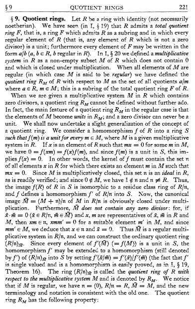

Screen shot 1
Oscar Zariski, Pierre Samuel, I.S. Cohen-Commutative Algebra v1 p - 221_page-0001.webp

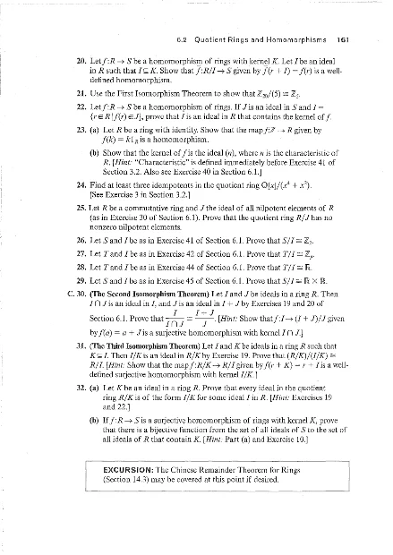

Screen shot 3
Thomas W Hungerford - Abstract Algebra An Introduction-Cengage Learning p 182_page-0001.webp
@fresh_42 in the above three screenshots. The first one has to do with Zariski and Samuel's passage. From the bottom of the page count up nine lines, where it starts with
'Since every element of ##f'(\bar{M})(=f(M))## is a unit in ##S,## the homomorphism ##f'## may be extended...'
I don't understand what the two authors meant by how they use the word extended. The author of the MSE answer mentioned that we don't know if ##\mathfrak{n}= \text{ker }f## in note 1. In the note 2, he mentioned the universal property of quotient map. Both note together can be amounts to theorem 11.3.13 in the second screen shot? Also, could the word extended to mean in the sense of ex 20 in the third screenshot.
Also if we expand in set builder notation for ##\bar{M}##, why can't I simply write it as ##\bar{M}=\frac{M+\mathfrak{n}}{\mathfrak{n}}=\{(m+\mathfrak{n})+\mathfrak{n}:m\in M\}=\{m+\mathfrak{n}:m\in M\}?##
