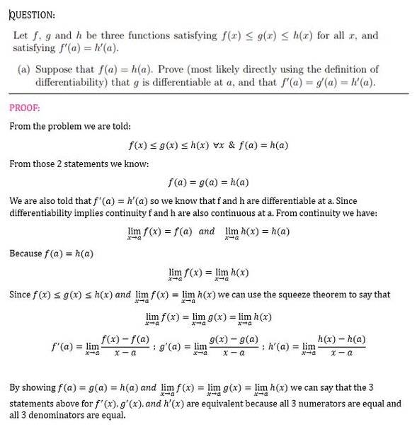

Problem Statement In Image Below
Squeeze Theorem and Limit Definition of Derivative
Below is the question and my attempt at a solution. From the info in the problem I tried to use the squeeze thm to show limf(x)=limg(x)=limh(x) all as x goes to a. Then that combined with f(a)=g(a)=h(a) I used to say all 3 derivatives are equal. Is my attempt below correct or did I make an error somewhere along the way. Thanks in advance.
Without losing generality we can do
a=0, f(a)=g(a)=h(a)=0.
When x>0
\frac{f(x)}{x} \leq \frac{g(x)}{x} \leq \frac{h(x)}{x}
x ##\rightarrow## +0
f'(0) \leq \frac{g(x)}{x} \leq h'(0)

First of all, allow me to invite you to use the LaTeX capabilities of Physics Forums when posting mathematical expressions. Find a link to the LaTeX Guide here or at the end of this Thread. You are likely to get better responses to your posts if you use LaTeX.
toslowtogofast2a said:
Homework Statement: Problem Statement In Image Below
Relevant Equations: Squeeze Theorem and Limit Definition of Derivative
I would say you haven't proved anything. You've more or less just stated that the result is obvious.
PS the question hints at using a direct ##\epsilon-\delta## approach, which might be a good exercise.
