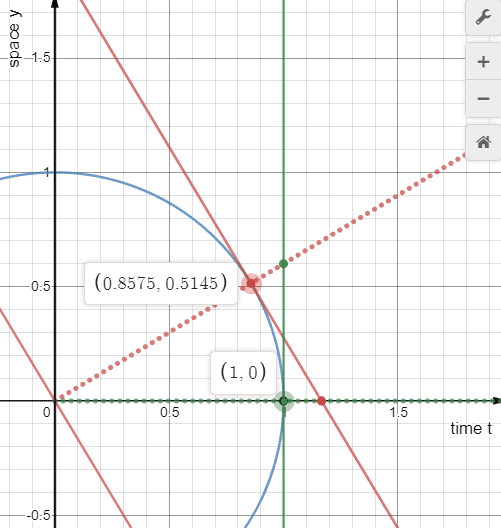

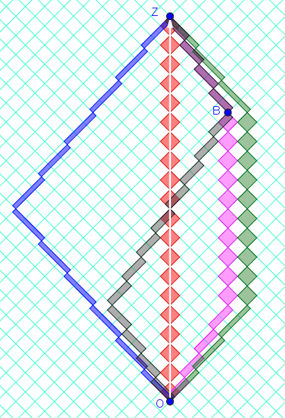

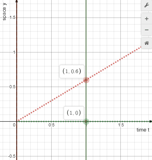

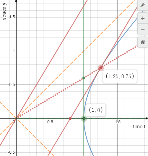

From a geometric viewpoint,
time-dilation compares
the measurer's t-component of the 4-velocity of the measurer [which is 1, since 4-velocities are unit vectors]
with
the measurer's t-component of the 4-velocity of an astronaut [which is what the measurer measures as the elapsed time between two ticks (marked by events) of the astronaut's clock].
These are equal only for the Galilean spacetime used in PHY 101: measurer measures [itex] \Delta t = 1 [/itex].
In special relativity, measurer measures [itex] \Delta t \geq 1 [/itex] (since [itex] \gamma=\cosh\theta \geq 1 [/itex]).. this is time dilation.
In Euclidean geometry (by analogy), [itex] \Delta t \leq 1 [/itex] (since [itex] \cos\phi \leq 1 [/itex].
See the diagrams below.
From this viewpoint, the key idea is that:
the general situation is that [itex] \Delta t \ne 1 [/itex]
and that the Galilean case is the exceptional case [not typical case].
It seems to me that the root of time-dilation is that the real spacetime we live in isn't Galilean...
but is pseudoriemannian with a Minkowski signature [for dilation].
Once this is realized, there's no need to include gravity or acceleration etc...
unless you want to calculate specific elapsed times.
Including them probably clouds the real issue above.
Our low-relative-speed lifestyles have led to our "common sense" Galilean notions of time.
Using https://www.desmos.com/calculator/wm9jmrqnw2
for Special Relativity (E=1), Galilean (E=0), and Euclidean (E=-1)...
[itex] \quad [/itex]
The bottom line is to calculate the elapsed time along different worldlines from event O to event Z.
The general case is that they are different.

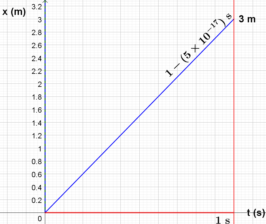

  • #64
Sagittarius A-Star said:
That's all fine, if you teach relativity to physics students. But the OP asks for a laymen explanation of the typical "twin paradox" scenario and states wrongly, that a scenario without real gravity would be symmetrically.
I think, for laymen an explanation with 4-vectors and 4D-spacetime may be too difficult to understand. An explanation comparing the empirical viewpoint of both twins maybe didactically better for an explanation to laymen.
The diagrams actually are intended for the lay person (after some introduction),
but the words I used for my reply weren't necessarily addressed to the layperson.
I see now I used "pseudo-riemannian" inappropriately to make my point
since Galilean is also pseudo-riemannian.
My main point is that
the way we use the position vs time graph in PHY 101 is only an approximation to what is really going on.
In fact, it is not well-appreciated that the position-vs-time graph is already a non-euclidean geometry.
Here's are the real measurements on a position-vs-time graph.
In this graph, the red lines are perpendicular to each other (in all three geometries mentioned earlier) and the blue segment is the hypotenuse. You can introduce units to redefine variables to make the sides have the same units... but that doesn't change the underlying geometrical relationships.
In PHY 101, we treat the blue segment as having length 1 (already in violation of Euclidean geometry)
but it's really length (approximately) [itex] 1-(5\times 10^{-17}) [/itex]. (Someday, we'll have a wristwatch that will measure this.)
The event that is "Length 1 along the blue segment" occurs to the right of the red vertical line.
This is time-dilation.
