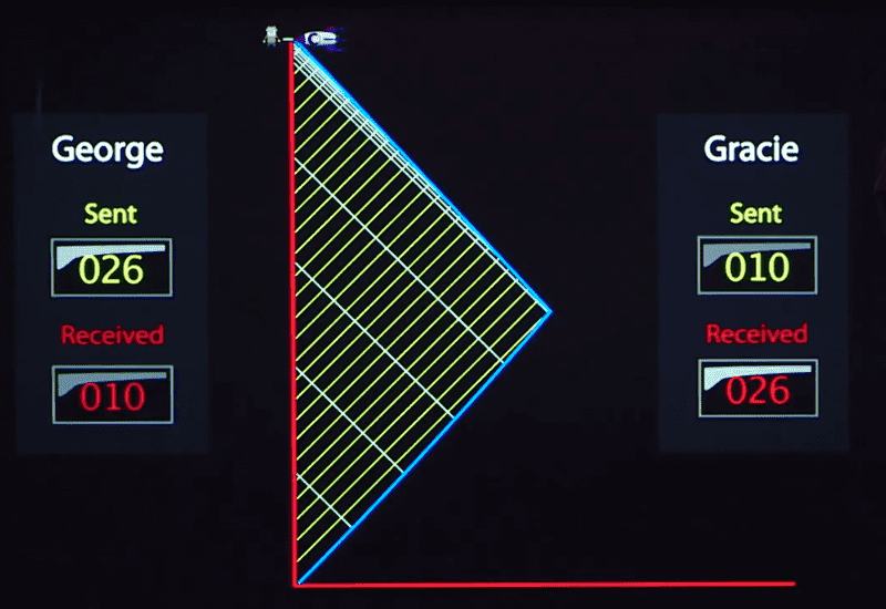

The answer is 170 ns. But I'm confused, shouldn't she observe 80 ns on George's earthbound watch (based on time dilation) at the turnaround moment? Based on the illustration from the course, it clearly shows that the light ray reaching the turnaround point is still from an older moment in time. Or am I misunderstanding the question?
Below is a diagram I'm referring to from his lecture video. Wouldn't Gracie only start seeing later moments of George along the journey back towards him?
The lecture video of the above screenshot is as follows (starting at 7th minute):
Can someone please enlighten me? Thank you.

Your reasoning is correct for the outbound leg, but the question is about the inbound leg. What time will George's watch read when Gracie's friend returns? What must it read just after turnaround, then?
Incidentally, this is not a good way to handle "what the traveler says about the stay-at-home's watch" precisely because you get these wildly inconsistent answers near turnaround.
Thank you for helping, Ibix. From what I understand, wouldn't Gracie (the traveler) be seeing sped up images of George (and his watch) as she travels back to earth?
If so, wouldn't George's watch read 80ns (or perhaps a little more) right at turnaround point, and then go faster along her journey back? What I don't understand is how come there's a sudden huge jump right at the turnaround moment to 170ns.
Shouldn't she only see George's watch display 170ns when she is more than halfway back to earth, based on the above diagram which shows George's yellow lines? 170ns means George already reached 85% of the entire journey duration, and his clock should only show that time when Gracie is almost back and not while she's still turning around?

You need to differentiate between what an observer acutually will see and what is happening in a particular inertial frame. Time dilation is related to how events are described in an inertial frame. The signal diagram and what signals arrive when is more related to what an observer would actually see.
Thank you, Orodruin. Do you mean that 170ns is what is actually "happening" to George when Gracie is turning around, although she will "see" 80ns?
Can you please guide me on how to calculate and arrive at the 170ns answer?

There's a difference between what you see and how you interpret it. For example, the still picture in your OP shows you that, at turnaround, the traveller will have just received the 10ns pulse from the stay-at-home. So the traveller sees the stay-at-home's watch reading 10ns at turnaround, then racing through the next 240ns over the return journey.
But the traveler can just subtract out the travel time of the light pulses to work out "what time it is now" at home. But you'll get different answers using the outbound and inbound inertial frames - that's where your 80ns and 170ns come from.
I see. So if Gracie is "seeing" 80ns on George's watch at the turnaround point, George's watch is actually already 170ns? Can you please guide me on how to calculate and arrive at that figure.

Use the Lorentz transforms. You are just going to confuse yourself mucking around with the time dilation formula. Time dilation alone cannot resolve the twin paradox - that's kind of the point.

You have to subtract that 80 ns from the total time that elapses on the staying twin's clock. Gracie spends 200 ns travelling, dilating George's time to ##\frac{5}{4}(200\ \mathrm{ns})## or 250 ns.

Gracie is "seeing" 10 ns on George's watch just prior to the turnaround point.
Gracie is "observing" 80 ns on George's watch just prior the turnaround point (i.e. +70 ns to account for the not-yet-seen light from George that is already in flight).
Gracie is "observing" 170 ns on George's watch just after the turnaround point. There is a discontinuity in what is "observed" because Gracie has changed her inertial frame and, accordingly, her idea of what time is "now" over where George's watch is. The hyperplane of simultaneity has swept forward along George's timeline to a point where George's watch has "now" ticked all the way up to 170 ns.
Grace is still "seeing" 10 ns on George's watch just after the turnaround point. There is no discontinuity in what is "seen".
Gracie has spent 100 ns outbound and has "observed" George's watch tick from 0 to 80 ns (net 80 ms).
Gracie will spend 100 ns inbound and will "observe" George's watch tick from 170 to 250 ns (net 80 ms).
Gracie has spent 100 ns outbound and has "seen" George's watch tick from 0 to 10 ns (net 10 ns).
Gracie will spend 100 ns inbound and will "see" George's watch tick from 10 to 250 ns (net 240 ns).

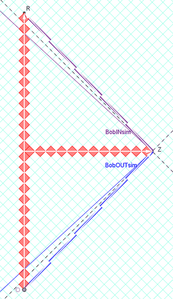

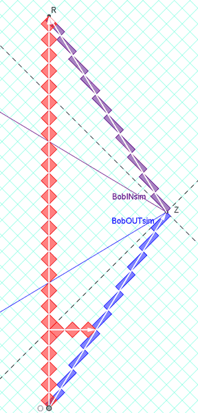

Here is a spacetime diagram on rotated graph paper
that can help visualize the comments that people made in this thread.
The (3/5)c case is on the left.
Using the language in the comments...
  • What you "see [visually... determined by receiving light-signals]" is based on light-signals joining source events and receiver events.
    • In my diagram, these light-signals are the dotted-lines, parallel to the grid of the rotated graph paper
  • What you "observe [happening simultaneously-"now" according to you.. determined (say) by radar]" is based on
    your instantaneous space-axis ("your spaceline"), which is Minkowski-perpendicular to your worldline.
    • In my diagram, I show the ticks of each observer's light-clock as light-clock diamonds. (All light-clock diamonds have the same area.)
    • The diagonals encode perpendicularity.
      Thus, the spacelines (lines of simultaneity) are the solid-lines, parallel to the spacelike-diagonal of the light-clock diamond.
      The set of spacelines for Bob change at the turn around event Z.
  • Because of the nice choice of numbers (exploiting pythagorean triples [here 3,4,5].. which leads to rational doppler factors [here 2]), you can count diamonds to obtain your answers.
(3/5)c for 10 ticks each way
