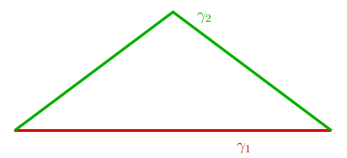

It's all rather trivial, as can be seen from examining a spacetime diagram of the situation.
Charles Carter said:
The unresolved issue remains lack of symmetry
That's not an "unresolved issue"; it's a physical fact about this particular scenario. The stay at home twin and the traveling twin are not symmetric; they have different physical experiences. The FAQ article that Dale linked to discusses this.

I have read your insight. If to chose the spaceship as the rest inertial frame, from the view of the twin in the spaceship, the twin on the Earth is younger. When the two twins meet, neither one is younger.
No, you are wrong. You have not understood the geometrical perspective at all. Reread the part where I explain (in the standard geometry case) why the "relativity of the x-coordinate" solves the problem by showing that the point on the straight line with the same x' coordinate as the turning point is not the half-way point. The twin paradox works exactly the same way.

No, this is wrong precisely because of the simultaneity of relativity. The spaceship does not have the same rest frame and applying the time dilation formula without taking relativity of simultaneity into account, you will be missing a large part of the time for the Earth observer. The spaceship changes system and that changes which event on the Earth is simultaneous with the turnaround.
