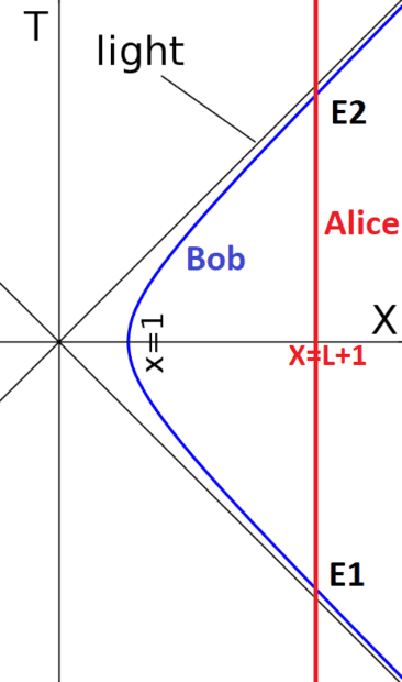

Twin Paradox: Alice with inertial motion, Bob with hyperbolic motion
Alice rests at ##X=L+1## in the inertial frame (T, X).
Bob is at rest in the Rindler frame (t, x) at ##x=1## and has the proper acceleration ##\alpha=1##.
In the rest frame of Alice, Bob moves from event ##E_1=(-T_2, L+1)## over the distance of ##L## in negative X-direction to event ##(0, 1)## and then returns to event ##E_2=(+T_2, L+1)##.
Because of time dilation, Bob's elapsed proper time, when moving form event ##(0, 1)## to event ##E_2##, is:
##t_2=\int_0^{T_2} \sqrt{1-\frac{v(T)^2}{c^2}} \ dT \ \ \ \ \ (1)##
Bob's velocity, when moving form event ##(0, 1)## to event ##E_2##, is:
##v(T) = \frac{\alpha T}{\sqrt{1+(\alpha T/c)^2}} \ \ \ \ \ (2)##
Source:
https://en.wikipedia.org/wiki/Hyperbolic_motion_(relativity)#Worldline
Plugging equation (2) into equation (1) and setting ##c:=1##
##t_2=\int_0^{T_2} \sqrt{1-\frac{\alpha^2 T^2}{1+\alpha^2 T^2}} \, dT =\int_0^{T_2} \sqrt{1-\frac{1}{1+1/(\alpha T)^2}} \, dT \ \ \ \ \ (3)##
Calculating the integral:
##t_2= \frac{\sinh^{-1} {(\alpha T_2)}}{\alpha}= \sinh^{-1} {(T_2)} ##
Example ##T_2 = 5##:
##t_2=\sinh^{-1} {(5)} \approx 2.31##
For symmetry reasons:
Alice ages by 10 years from event ##E_1## to event ##E_2##.
Bob ages by 4.62 years from event ##E_1## to event ##E_2##.

Nice calculation! Just a couple of comments:
Sagittarius A-Star said:
Plugging equation (2) into equation (1) and set ##c:=1##
##t_2=T_2\int_0^{T_2} \sqrt{1-\frac{\alpha^2 T^2}{1+\alpha^2 T^2}} \, dT =T_2\int_0^{T_2} \sqrt{1-\frac{1}{1+1/(\alpha T)^2}} \, dT \ \ \ \ \ (3)##
First, there should not be a factor of ##T_2## in front of the integral here (and you drop it later on).
Second, a simpler form for the integral, which matches up more nicely with what you are likely to find online for the derivative of ##\sinh^{-1}##, is
\int_0^{T_2} \sqrt{\frac{1}{1 + \alpha^2 T^2}} dT
With the simpler form for the integral I gave above, evaluating the integral gives
t_2 = \sinh^{-1} \left( \alpha T_2 \right)
Plugging in ##\alpha = 1##, which you specified in the problem statement, gives the result you obtain, ##t_2 = \sinh^{-1} T_2##.
Corrected, thank you!

I haven't checked the rest of your working, but in the Wikipedia article ##v## is ##\tanh\tau##, not ##\tanh t##.
Likes Sagittarius A-Star
Does someone find the error(s)?
You can't assume that ##v## in Rindler coordinates is the same as ##v## in Minkowski coordinates.
I think, with ##\tau## they mean in Wikipedia the proper time of Bob. In the accelerated rest frame of Bob that is equal to ##t##, because Bob is at rest at ##x=1## and ##\alpha := 1##.
Yes, that was the error. I corrected it by multiplying the original term for ##v## with ##\alpha x(t)##, because also the velocity is effected by "gravitational" time dilation.
Thank you!
