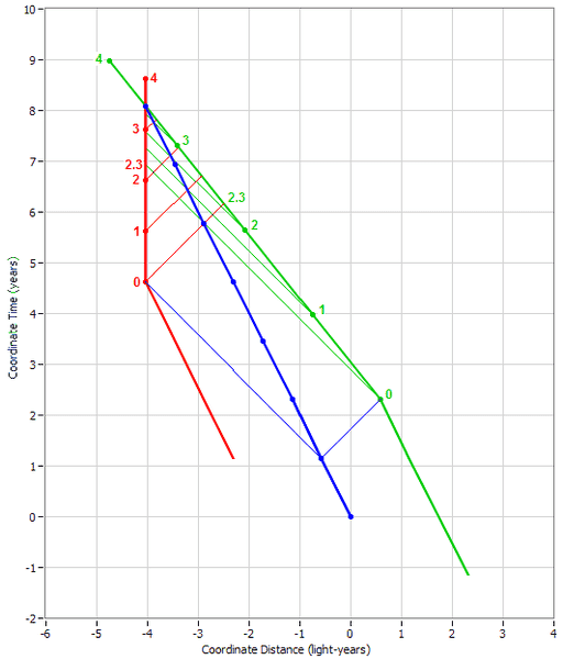

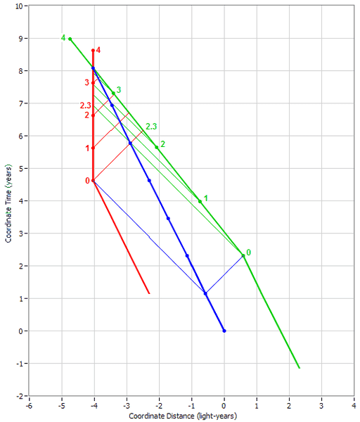

Re-uploaded diagrams
Trojan666ru said:
That's what i do not understand yet. Even before starting experiment (while everybody is at rest with respect to everyone) how can the green box receive the information for acceleration earlier than red box?
You showed the rest frame for the red box after acceleration. Here's the rest frame for the red box before acceleration with the Proper Times on their stopwatches marked:
The issue of which box received the signal first depends on the frame because we are talking about simultaneity issues which are frame dependent. If you look at the third diagram in my first post (#17) you will see that the red box receives the signal for acceleration earlier than the green box. In the above frame, they both receive their respective signals at the same Coordinate Time of 3 years when their stopwatches are activated to start ticking from zero. But neither one can see that the other one received his signal at the same time as his own. Observers cannot see Coordinate Times for remote events.
But later on, each one can see the other one receiving the reflected signal or the image of the Proper Time on the other ones stopwatch. In the above diagram, can you see that the green signal that came from the green box when it started to accelerate (at its Proper Time of zero) arrives at the red box when the Proper Time on his stopwatch reached about 2.3 years? I hope the Proper Time markings have made this very clear.
The same thing applies for the green box watching the Proper Time on the red box's stopwatch. He also sees the red box's stopwatch start ticking when the Proper Time on his own stopwatch reaches 2.3 years.
I have added the same Proper Time markings on the diagram that you showed:
Can you see that the Proper Times on both stopwatches and the signals that go to and from them are identical in both frames even though the Coordinate Times and Coordinate distances are different? Both of these frames contain identical information. The boxes don't know that we have drawn two different diagrams with different coordinates. All they know is what they can see when, according to the Proper Times on their own stopwatches, the signals arrive at their own locations.
  • #82
I can't see you drawings from #81 have you removed it?
  • #83
Trojan666ru said:
In the beginning all three boxes were at rest relative to each other. It is also clear that from all three observers point of view the distances are well defined (ie 4Ly in total and in the middle a half silvered mirror)
I answered this post already but it wasn't a very good answer.
Now I want to show how each observer/object can use radar signals and other observations to determine the answers to all your questions. The important point is that they each will follow the exact same procedure that you described in your very first post where the observer sends signals to the other objects and watches for the echo to get back to him, along with his observation of the time on the other objects' clocks so that he can verify how far away they are from him. And most importantly, the apply Einstein's convention that light travels in all directions at c. It is this one fact that makes the simultaneity issues different in each frame.
So for this purpose, we need to have clocks attached to each object (not just inactive stopwatches that are started at a particular time). We will assume that all three clocks are synchronized to the Coordinate Time in the defining Inertial Reference Frame (IRF) that applies when all three objects are in mutual rest. Here is a spacetime diagram for the defining IRF with Proper Time markings for the red and green boxes. The Proper Time for the blue coordinator matches the Coordinate Time so I didn't make special markings for him. I had to continue the scenario on both ends to enable the radar signals to work:
I have also marked the same signals that are shown in post #61, namely a pair sent by the blue coordinator at his 1-year mark and received by the boxes at their 3-year marks to start their accelerations toward the coordinator and another pair sent by the blue coordinator at his 6.2-year mark and received by the boxes at their 7-year marks when their accelerations end and when they start their stopwatches (which we are not concerned with now) and when they echo signals back toward the coordinator and the other box. When those red and green signals pass through the half silvered mirror located with the coordinator, I show them as yellow as they progress to the other box.
Now I want to go through a little exercise to show how an observer can use radar signals and other observations to construct his own reference frame in which he is at rest. I will start with the blue coordinator because he is already at rest in the defining IRF and the process will be much more obvious. Here is a diagram showing the important blue radar signals that the coordinator sends out and the return reflections coming from the red and green boxes. The coordinator has to be sending out radar signals much more often than I am showing them but I have selected just a few that will make our process easier to perform:
For each radar signal that is sent, the observer keeps track of when it was sent according to the Proper Time on his own clock. After he receives the reflection, he keeps track of the received time and the observed Proper Time on the target. He keeps a log of these three numbers for each radar signal. Then he calculates a distance and a time for each set of numbers. These calculations use Einstein's convention that the radar signal takes the same amount of time to reach the target as it takes for the reflection to get back to the sender. The distance is merely the received time minus the sent time divided by two and then multiplied by the speed of light which in our example is 1. The time at which this distance applies is the average of the sent and received times. This will enable him to make a diagram showing his results as a function of his Proper Time. He is doing this separately for each object.
Let's go through one example at the bottom of the diagram. At his time of -6 years, the coordinator sends out a radar signal (in both directions but we can focus on just one). At his time of -2 years, he gets the reflection signal. He takes the difference, which is 4 and divides by 2 to to get a distance of 2 light-years. He knows that the distance is to the left for the red box and to the right for the green box. He averages -6 and -2 to get -4 as the time the box was 2 LY away. I hope this is clear. Now he just repeats this over and over again and from the calculations, he can draw a diagram just like the one we have been looking at. As he gets to the portions where the boxes are accelerating, his log of sent and received times will include times with fractional parts so we have to interpolate between the dots. Here is his final diagram:
Now we want to graduate to the red box who is going to make a diagram showing the position of the coordinator and the position of the green box as a function of his own Proper Time (marked off by the red dots). We start with the same original defining IRF and draw in the red radar signals sent by the red box and going to the blue coordinator. The reflections are shown in blue as they come back to the red box:
Next, we have a similar diagram showing the red radar signal going to green box and the green reflections coming back to the red box:
And here is the diagram that the red box constructs from all the radar signals and observations of the Proper Times of the other two objects:
I have drawn in the same signals that were in the first diagram in this post so that we can see that the signals arrive at the same times.
Trojan666ru said:
But somehow from the red box’ point of view, the green box receives the signal from the coordinator earlier than the red box. Why is it so?
It's because the red box is applying Einstein's convention that light travels at c in his rest frame.
Trojan666ru said:
Is that because the coordinator sends the green signal earlier and red later?
No, in all frames, the blue coordinator sends signals to both boxes at the same time.
Trojan666ru said:
Or
The distance between the coordinator and red box suddenly increased & the distance between the coordinator and green box decreased?
Not suddenly but gradually as you can see in the last diagram. But again, this is because the red box is applying Einstein's convention to his rest frame. It's not something that he can see or something that is intrinsic to nature. It's a man-made convention (the man being Einstein).
I said at the start that I didn't like my previous answer. I didn't realize at that time that the what you said about the two distances is true but now I realize that those two distances are different in the red box's rest frame. But, keep in mind that we could do this exercise all over again from the point of view of the green box and everything would be opposite. Then the red box would receive the signals from the coordinator earlier than the green box. It all has to do with Einstein's convention and the fact that the farther away an object is, the earlier you have to send a radar signal to it and the later you get its reflection compared to a closer object.
Well, I hope this helps. Keep asking if you have more questions. But please study this response in detail first.
  • #84
No, at least not on purpose. I don't know why this happens. I can see them on my webpage which means I did upload them but for some reason after doing all the edits, they don't appear for others on the final submission even though they appear for me.
Anyway, I have re-uploaded them so hopefully you can see them now.

If you have two observers, A at rest relative to a subject some distance away, and B in inertial motion retative to them, and you get observer C that "jumps ship" from A to B at the moment when the two cross, C would not agree with A about the distsance or velocity of the subject a certain time before the jump, nor with B a certain time after it, despite being in exactly the same spot observing exactly the same things as them at the specific moment. Such a system is not something you'd see in a physics textbook, ever.
  • #91
georgir said:
If you have two observers, A at rest relative to a subject some distance away, and B in inertial motion retative to them, and you get observer C that "jumps ship" from A to B at the moment when the two cross, C would not agree with A about the distance or velocity of the subject a certain time before the jump, nor with B a certain time after it, despite being in exactly the same spot observing exactly the same things as them at the specific moment. Such a system is not something you'd see in a physics textbook, ever.
I don't know that I've ever seen it in a textbook, but it's certainly fair game for discussion during office hours - that's where I first encountered it. There's also at least one thread somewhere here that discusses this situation.
It's not so interesting in this simple example. If the velocity of the subject relative to A and to C is the same, and then C changes speed, then of course the velocity of the subject relative to C will change and therefore no longer be equal to the velocity of the subject relative to A, and that's no great surprise.
It is more interesting (at least an exercise in demonstrating the consistency of the Lorentz transforms) if you combine this frame-jumping with the traditional twin paradox. The subject is the stay-at-home twin, C is the traveling twin, and at the turnaround point he jumps from his outbound spaceship onto another ship that happens to be traveling in the opposite direction, inbound. Now consider how C reconciles his recollection of events with the ship's log that's been maintained by the crew of the incoming ship.
  • #92
georgir said:
I know that gradual acceleration would be a hell of a math puzzle for me
And luckily I don't need to solve it anyway, as people have done it already. It's an interesting solution, with time rates dependant on distance from the observer, an apparent event horizon behind him and what not...
  • #93
Nugatory said:
If the velocity of the subject relative to A and to C is the same, and then C changes speed, then of course the velocity of the subject relative to C will change.
But radar method will tell you that the velocity of the subject changed a while before C changed his, and then again a while after, and that's the wonky part that will never fly.
  • #94
Why not? The coordinates are non inertial so why shouldn't the coordinate velocity change before and after?
  • #95
Because describing the current the state of the world should not depend on what I did once upon a time, and even less so on what I will do in the future, just on my current state as an observer. And any other observer that is momentarily identical to me should agree with me.
  • #96
Why on Earth would I accept such propositions? The whole reason the Einstein definition of simultaneity makes so much sense for inertial frames is the particular past (and future - to receive a signal from what I think of as now). So two observers whose past and future are different have no reason whatsoever to agree on simultaneity just because their current instantaneous velocity is the same. Any operational synchronization procedure they use will come out different.
FYI, it is a historic fact that Einstein never used or endorsed your proposition for dealing with accelerated motion in SR. He did, in one paper, use radar coordinates. But mostly he just chose to not bother with a 'frame' for accelerated observer at all. Any observation by the accelerated observer can be derived most simply by using any single inertial frame over whole period of interest.
  • #97
This is absolute nonsense. Not only does the formalism of SR, and Einstein simultaneity for non-inertial observers in particular, disagree with you but also you're making hand-wavy arguments in favor of your utterly flawed intuition.
  • #98
And right here is your problem: you think that "the current state of the world" is a well-defined concept. It isn't. The world does not have a unique "current state". You, at a particular event on your worldline, have a current state, but that's because you are a localized object. The different ways of assigning a "current state" to the rest of the world, at events spacelike separated from a particular event on your worldline, are arbitrary conventions; none of them make any difference to any physical predictions.
This, by the way, points out another flaw in your argument: you are assuming that a given observer is *forced* to use a certain simultaneity convention (which is what assigning a meaning to "the current state of the world" amounts to). That is a necessary premise for your further claim that two observers who are momentarily comoving must use the same convention, which is what your claim that "the current state of the world" must be the same for two momentarily comoving observers amounts to. This claim is false because the premise is false: any observer, in any state of motion, can choose whatever simultaneity convention he likes. Simultaneity conventions are just that: conventions, arbitrary choices that do not affect any physical predictions.
  • #99
For some reason this issue keeps coming up even though it's really not that non-intuitive. The problem is some people seem to be stuck on Aristotelian notions of time and the "now". In Galilean relativity there is a prescribed partitioning of space-time into classes of "now" so there is no issue but in SR things aren't so simple. The only thing nature provides us with is light cones. Furthermore clocks only keep time at their locations. An accelerated clock and a momentarily comoving inertial clock will only be inherently equal at their common location (assuming the accelerated clock has been calibrated so as to prevent deviations from inertial clock behavior) because again clocks only keep time of local events. When you have clocks separated in space you need to adopt an arbitrary convention that prescribes how to synchronize clocks i.e. a convention that prescribes when two clock readings are simultaneous. For spatially separated inertial clocks there is a natural such clock synchronization convention and this is the Einstein synchronization ("natural" because it is directly related to orthogonality with respect to the world lines of the clocks as defined by ##\eta_{\mu\nu}##). For non-inertial clocks there is no such natural synchronization convention.
I would really recommend reading "Relativity and Geometry"-Torretti. It's a very cheap book and it has detailed discussions of clock synchronization/simultaneity.
  • #100
I agree totally with the first part of Peter's comment. However, I have a few remarks about the following:
This part of the argument I think needs a more lengthly treatment. There was a quote from Einstein on this point earlier - there is a unique simultaneity convention that's required to make Newtonian mechanics work. So while choice of simultaneity may be optional, if you have an IRF and you want to make Newtonian mechanics work, your choice of simultaneity conventions isn't arbitrary, you must choose the required option.
"Making Newtonian mechanics" work is a bit vague. The issue is that in order for the momentum p to be equal to m v, mass * velocity, one needs the correct simultaneity convention. While it is possible to find a Lagrangian to give one the correct conserved momentum and equations of motion,the usual formulation of Newtonian mechanics as taught in high school does in fact _require_ certain choices about the "convention" of simultaneity. As Einstein pointed out, the same choices that make Newtonian mechanics work (in the above sense) also make Maxwell's equations work - which in turn makes the speed of light in a vacuum equal to "c".
Einstein also demonstrated that the "required" simultaneity conventions generate different sets of "simultaneous" points for different observers to the same event O. So there isn't any "universal" notion of simultaneity that makes Newtonian mechanics work for everyone.
  • #101
The problem with this is that changing rest frames shifts your notion of which events are "now". You could try saying:
If an observer is at rest in frame A up to time T, and is at rest in frame B afterward, then you use A's coordinates for events that took place before time T and use B's coordinates for events that took place after time T.
But the problem is that there are some events that take place after time T, according to frame A, but before time T, according to frame B. These events are not described at all in the patched-together coordinate system.
Another problem is that there are some events that take place before time T, according to frame A, but after time T, according to frame B. These events would appear twice in the patched-together coordinate system.
So even though it sounds plausible that an accelerating observer need only be concerned with what he's doing now, rather than what he's doing in the future or the past, it's not clear how to make that consistent.
  • #102
Why? I don't recall ever reading any of those points as being a requirement of a coordinate system. Do you have a reference justifying any of that?
  • #103
georgir said:
You and DaleSpam are both free to continue using it of course, but try not to completely distract people interested in learning the subject from the much simpler and objective system of direct application of the Lorentz transforms for the momentarily comoving inertial reference frame of the observer.
I also prefer to use a momentarily comoving inertial frame (MCIF). However, a non-inertial observer is not always at rest in any of its MCIF's, and therefore none of the MCIF's are a candidate for being "the observer's frame".
I think that the utility of "the observer's frame" is rather limited, but if you insist on using such a concept then you have to actually look at the gory details of non-inertial frames.
  • #104
A separate point from those made so far: you assume momentarily identical means momentarily identical velocity. But that is not the only kinematic property of a body. There is also proper acceleration. You arbitrarily assume this should make no difference for a 'preferable' notion of simultaneity.
  • #105
This is a very important point!
When you synchronize two clocks all you're doing is defining what it means for mutual clock readings to be simultaneous. But, as PAllen noted earlier, the clock synchronization convention is operational. There has to be some kind of communication between the two clocks in order to synchronize them according to whatever convention has been adopted. As such you can't use a single event in your vicinity to determine if your clock is synchronized with another clock i.e. you can't use just this local event to define what it means for your clock reading and other clock readings to be simultaneous-simultaneous events are space-like separated so they can't causally influence one another. As such a determination of distant simultaneity by means of communication to and from distant clocks will involve past and future events in your vicinity. If you want to say "now we know that my clock is synchronized with your clock so whenever my clock says ##t_0## your clock will also say ##t_0## simultaneously, thus we have defined simultaneity of events" you will necessarily involve past and future events on your world line. This goes for both inertial observers and non-inertial observers. Hence the behavior of the world line at just a single event isn't enough to determine simultaneity meaning proper acceleration and rotation will both influence the determination, as PAllen noted. Whether you choose to use the MCIF's set of simultaneous events or the non-inertial observer's set of simultaneous events is an arbitrary choice-nothing in nature says one is right and the other is wrong. However both will necessarily involve past and future events on the world lines of the respective observers.
