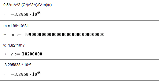

I tried solving it and i was able to do a) and b)
here is what i did on c), but its not correct according to the solution
It's not correct because there are two black holes with speed v. Your kinetic energy term 0.5*m*v^2 is that of a single black hole.

Hmm, but what is the radius then?

So i should just muliply it by 2?
Are you asking me or are you telling me? What do you think?

Im asking you, cus the anwser is still wrong
If you add two quantities that are equal, you should get twice the amount of one. The problem is not with the kinetic energy. Check your potential energy. How did you get U = -(G(v^2*r)/G*m)/(r)? I would recommend simplifying the expression before putting in the numbers.
