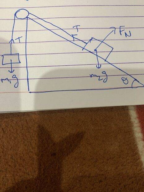

A 55 g mass is attached to a light string, which is placed over a frictionless, massless pulley, and attached to a 199 gm block which is on a board inclined at 39.3° as shown. Assuming the block starts at rest and the ##\mu_k## between
the incline and block is 0.38, how long will it take the block to move 13 cm?
##F_Net=ma##
1. ##-f_k\cos\theta-T\cos\theta+F_n\cos\alpha=m_2a_x##
2. ##f_k\sin\theta+T\sin\theta+F_n\sin\alpha-m_2g=-m_2a_y##
3. ##T-m_1g=m_1a_y##

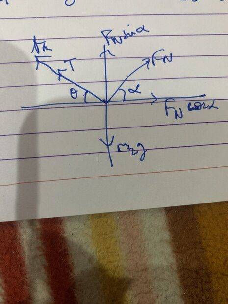

I am unable to get anywhere. There are accelerations in x , y directions.
I need the value of acceleration. Then I can simply use ##s=ut+\frac12at^2##

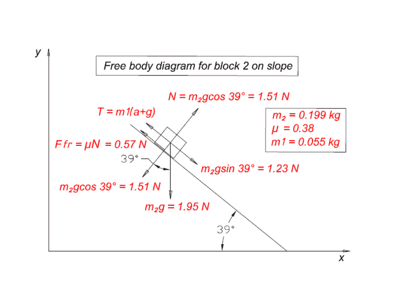

The magnitude of the acceleration is the same for both blocks because the connecting string does not stretch or shrink. It's OK to have differently oriented axes for separate FBDs. The one for the hanging mass is fine. For the mass on the incline, orient the axes to be parallel and perpendicular to the incline. That should make the equations simpler to write down and manipulate because the component of the acceleration perpendicular to the incline in the second FBD is zero.
Likes Lnewqban and Steve4Physics

They are not unsolvable but you don't have enough of them and the ones you have are not error-free. You have not included the constraint that the magnitude of the acceleration is the same for both blocks and what you have for the acceleration components is incorrect. In your equations (2) and (3) you assign to the vertical components of the acceleration of ##m_1## and ##m_2## the same symbol ##a_y##. That means that the magnitude of the acceleration of ##m_1## is ##a_y## while the magnitude of the acceleration for ##m_2## is ##\sqrt{a_x^2+a_y^2}##. Unless the horizontal acceleration for ##m_2## is zero (which it isn't) the magnitudes are not equal. Furthermore, you are making your task even more difficult by introducing angle ##\alpha##. As I indicated in the other thread of the person standing on the incline, doing something like this raises barriers rather than facilitate algebraic manipulation.
The widely used advice for FBDs is "Orient your coordinate axes so that the acceleration is along one of the principal axes." This is excellent advice because when you write Newton's 2nd law, the right-hand side of one equation is zero. You can do that because the accelerating mass doesn't know or care which way you chose to orient your axes. It will accelerate just the same. Try my way, actually the widely recommended way, first and then try the horizontal-vertical orientation for the incline FBD if you have a penchant for unnecessary and tedious work. I do not.

@rudransh verma, it is not 100% clear to me (without doing calculations) which direction the block on the slope will slide on release – uphill or downhill? You might want to check this.

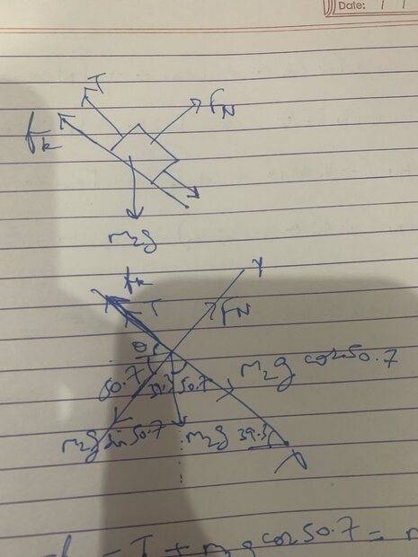

I got it. t= 0.733 secs. Thanks. It has become so easy like this.
Likes kuruman
That's the number I got. Congratulations.

In equation (3) the right hand side has ##a_y## for the vertical component of the acceleration of ##m_1##. Here the acceleration vector is in the vertical direction, so the magnitude of the vertical component is the same as the magnitude of the vector.
In equation (2) the right hand side has also ##a_y## for the vertical component of the acceleration of ##m_2##. Here the acceleration vector is not in the vertical direction and the magnitude of the vertical component cannot be the same as the magnitude of the vector. So equations (3) and (2) are inconsistent because they require two different values for the same variable.
On edit: The segment above has been edited to correct a mixup of equations and masses as pointed out by OP in post #11. Also see retraction in Post #13.

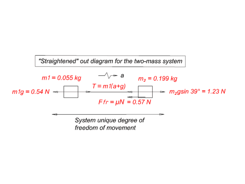

If you want to know which way the masses accelerate, just compare the two competing ‘driving’ forces and see which is biggest:
- the weight of mass-1: ##m_1g## vertically downwards;
- the downhill component of the weight of mass-2: ##m_2gsin θ## downhill to the right
Of course, you only really need to compare ##m_1## and ##m_2sinθ## as the ‘g’s cancel.
A few seconds on your calculator does the trick.
