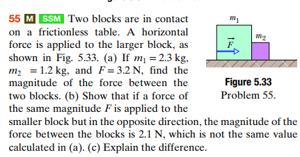

Two blocks in contact -- find the force between them
lola9
Two blocks

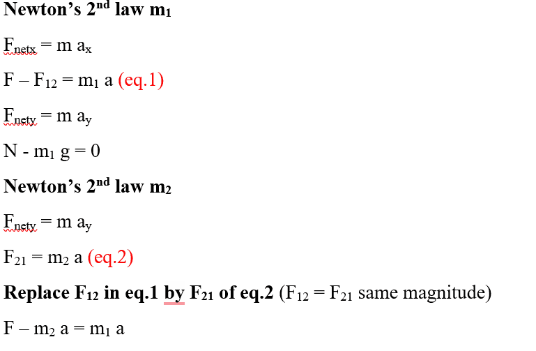

F netx = m ax
F – F12 = m1 a
In this problem why do I need to use this formula? F – F12 = m1 a along the x-axis. What does F12=-F21 stand for? And I don't understand when they say to find the magnitude of the forces between the two blocks
Newton's third law.
Because it is Newton's second law applied to this problem.

The force balances on the two blocks separately are $$F-f=m_1a$$and $$f=m_2a$$where f is the magnitude of the contact force between the two blocks and a is the acceleration of the blocks. If we add these two force balances together, we obtain $$F=(m_1+m_2)a$$

By Newton III, action and reaction are equal and opposite. That means that if body A exerts a force ##\vec F_{AB}## on body B at some instant then, necessarily, body B exerts force ##-\vec F_{AB}## on body A at the same instant.
These two forces have the same magnitude; only their directions differ.

So you are telling me to abandon a field because I do not understand one problem? The problem I asked an explanation for is here to help me understand and apply Newton's law. So it is normal that I ask a question about the fundamental laws. Take into consideration that some people are slower than others. It takes time for me to understand some problems but that does not mean that I am incapable of doing physics or that I should find another field of study. I had a problem with that exercise because most of the time I use Newton's second law to solve that type of problem. I just did not understand why I needed to use the third law instead of the second law. That was my question

You use both of them. Draw well-separated free-body diagrams of each block. Use Law II to show that the net force on each block is nonzero. Use Law III to show that the forces that the blocks exert on each other are equal in magnitude but opposite in direction.
