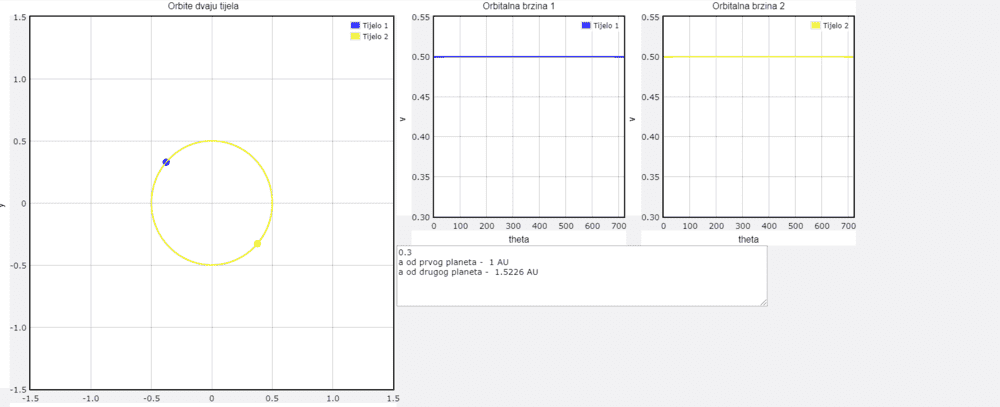

yes, sorry, speeds as I use vis viva equation to calculate relative speeds at every point, and with those equations I derived at the end I calculate velocities of single bodies. However, I do not have any such problems in my simulation, this is what I get for relative speed in perihellion of 1, and eccentricity of 0:
245348
Bodies are on the same trajectory, a diameter of a circle apart, and their speeds are half of the initial relative speed on every point of trajectory.
I get it, in my sim I use vectors, and in the denominator I subtract vectors then calculate the magnitude. In final result of my derivation, magnitudes of r1 i r2 would be equal if masses were equal so that would yield 0 in the denominator.
If I argued that velocity vectors were in opposite directions, because cross product of their angular velocity and position vector is in opposite direction, so relative speed between two bodies must be equal to sum of their magnitudes instead of difference, I would get r1+r2 in the denominator and valid result, right?
pobro44 said:
I get it, in my sim I use vectors, and in the denominator I subtract vectors than calculate the magnitude. In final result of my derivation, magnitudes of r1 i r2 would be equal if masses were equal so that would yield 0 in the denominator.
Yes, ##\frac{v_1}{r_1}=\frac{v_2}{r_2}=\frac{v_1+v_2}{r_1+r_2}##.
