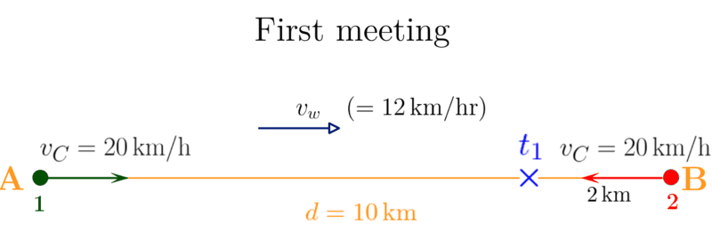

Meeting 1 : I start by drawing an image of the problem for the first meeting the position of which is shown by the blue cross mark (##\color{blue}{\boldsymbol{\times}}##). This meeting should happen 2 km from B because (cyclist) 1 should travel a greater distance (8 km) in the same time as 2 (2 km) due to wind. If this meeting happens at a time ##t_1##, then
##\small{t_1=\dfrac{8}{20+v_w}=\dfrac{2}{20-v_w}\Rightarrow v_w = 12\,\text{km/h}}\quad{\Large{\color{green}\checkmark}}##. This answer matches with the text and I have put it in the diagram.

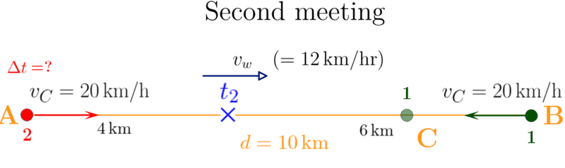

Meeting 2 : Here 2 has come to A and 1 has gone to B. When they start again, they meet at a point 6 km from B or 4 km from A shown by the blue cross mark (##\color{blue}{\boldsymbol{\times}}##). If neither cyclist had waited, they'd meet again at the same place as before, 2 km from B. But because they meet earlier than that, the cyclist from A (cyclist 2) must have lost ground and therefore it must have been him who rested at A (##\color{red}{\large{\boldsymbol\times}}##) for a time ##\Delta t## before starting his journey back to B.
This answer is wrong, as per the text.
During this time, 1 must have covered a distance ##20\Delta t## and reached a point shown as C in the diagram. Hence, when 2 is supposed to start from A, their distance of separation ##\Delta x_2=10-20\Delta t##. But 2 had to travel 4 km, hence the time of the meet ##\small{\Delta t_2=\dfrac{4}{20+12}=\dfrac{1}{8}\,\text{hr}}##. But this is also the time that 1 got to travel from B's side : ##\small{\dfrac{1}{8}=\dfrac{10-20\Delta t-4}{8}\Rightarrow 6-20\Delta t=1\Rightarrow 20\Delta t=5\Rightarrow \boxed{\Delta t =\dfrac{1}{4}\,\text{hr}=15\,\text{mins}}}\quad\color{red}{\large{\boldsymbol\times}}##.
Correct answers : ##\text{The cyclist 1 stops at B for a time of 18.75 mins}##.
Request : Where do you think am I going wrong? Thanks for the time and the trouble.

The wind is blowing from A to B, so the cyclist travelling from A to B (C1) goes faster than the other (C2). They must meet 2km from town B. That means that C1 travels 8km while C2 travels 2km. And the wind speed is 12km/h.

There are a couple of mistakes I can spot.
brotherbobby said:
... If neither cyclist had waited, they'd meet again at the same place as before, 2 km from B.
For the part 1 journeys, the cyclists leave A and B simultaneously, meeting 2km from B. But do the cyclists arrive at A and B simultaneously? So (if neither cyclist waits) would they start their part 2 (return) journeys simultaneously? Does this affect the position of their 2nd meeting?
You have forgotten that cyclist 1 is not travelling at 20km/hr.

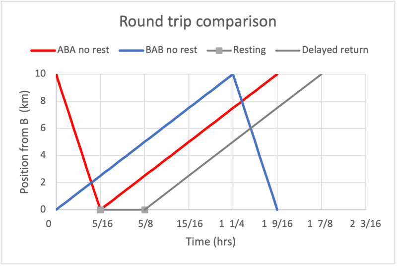

I opted for a graphical solution that illustrates the points made earlier. I first plotted the position vs. time round trips for the two cyclists assuming that neither rested. These are represented by the blue and red lines in the plot below. The first meeting is at 2 km from B at t = 5/16 hr = 18.75 min. If neither rests, the second meeting will occur at the symmetric point of 2 km from A or 8 km from B. For the second meeting to occur at 6 km from B, the cyclist starting at A (red line) must be delayed by resting. To find the resting interval, note that the red line from B to A is parallel to the blue line from B to A and that a delay of 5/16 hrs results in a position difference of 2 km. Thus, if the red line cyclist is delayed for an additional 5/16 hrs by resting, the gray line representing his position will drop by an additional 2 km when it intersects the blue line. This can also be shown, perhaps more formally, by considering similar triangles.
To summarize, the blue line represents the round trip of the cyclist who starts at B and does not rest. The red line from t = 0 to t = 5/16 hrs represents the "go" trip for the cyclist starting at A; the gray line between square markers represents his resting interval; the gray line from t = 5/8 hrs to t = 1 9/16 hrs represents his "return" trip.

  1. Your diagram and workings in the OP for the first meeting are correct.
  2. You can then see that it takes C1 ## \frac{2}{32} = \frac{1}{16} ## hour to get to A and C2 ## \frac{8}{8} = 1 ## hour to get to B.
  3. Your diagram for the second meeting is also correct, and from this you can see that it takes C1 ## \frac{6}{8} = \frac{3}{4} ## hour and C2 ## \frac{4}{32} = \frac{1}{8} ## hour to get to the second meeting.
  4. The total travel time between meetings for C1 is therefore ## \frac{1}{16} + \frac{3}{4} = \frac{13}{16} ## hour and for C2 ## 1 + \frac{1}{8} = \frac{9}{8} ## hour.
  5. C1 therefore rests for ## \frac{9}{8} - \frac{13}{16} = \frac{5}{16} ## hour or 18.75 minutes.

I don't think that there is generality to be lost. The author of the problem, although a bit cagey, provides enough information to identify the town as B. This became apparent to me when I constructed the plot in post #12. Here is what we are told.
  1. The wind blows from A to B. Therefore the "go" trip for cyclist A takes less time than the "go" trip for cyclist B. It follows that the first encounter at 2 km "from one of the towns" identifies the "from" town as B. OP expressed as much in post #1.
  2. The cyclists depart simultaneously which sets clock time ##t = 0## when this event occurs. If one is to produce a position vs. time graph for both cyclists, the first encounter point must be closest to the origin of position/ time coordinates which sets town B as that origin.
If we were to set town A as the origin of coordinates, then we would have to change the direction of the wind.
