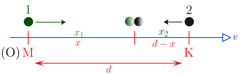

The problem is divided into two parts. In the first part, both launches leave their stations at the same time.
##(\rm{a}) -\text{Simultaneous leaving}##
I draw the situation of the problem alongside. Let the stations be a distance ##d## apart and the river to flow with a speed ##v##. Let each launch move with speed ##u## relative to river. Let the launching station M also be te origin, O. Both launches meet at a distance of ##x## (from O).
Launch 1 leaves M and 2 leaves K - since the launch from M takes longer to go and return, 1 it must be travelling downstream first for a greater distance also to meet 2. Let us use single primes ##'##s for forward motion and double primes ##''##s for return.
Time taken by both launches are the same for them to meet : ##\small{t'_1=\dfrac{x}{u+v}=\dfrac{d-x}{u-v}=t'_2\Rightarrow x=\dfrac{u+v}{u}\dfrac{d}{2}=x_1\quad \left(>\dfrac{d}{2}\right)}##. The distance travelled by launch 2 ##\small{x_2=d\left( 1- \dfrac{u+v}{2u} \right)=\dfrac{u-v}{u}\dfrac{d}{2}}##. The common time for them both ##t'_1=t'_2=\dfrac{d}{2u}##. To return, the first launch will take a time of ##\small{t''_1=\dfrac{u+v}{u-v}\dfrac{d}{2u}}## and the second launch ##\small{t''_2=\dfrac{u-v}{u+v}\dfrac{d}{2u}}##. Adding the forward and return times for both launches and equating them to the times given, we find the total time for launch 1 ##t_1=\dfrac{d}{u-v}=3\quad\color{blue}{(1)}\quad## and for launch 2 ##\quad t_2= \dfrac{d}{u+v}=\dfrac{3}{2} (=1.5)\quad\color{blue}{(2)}##

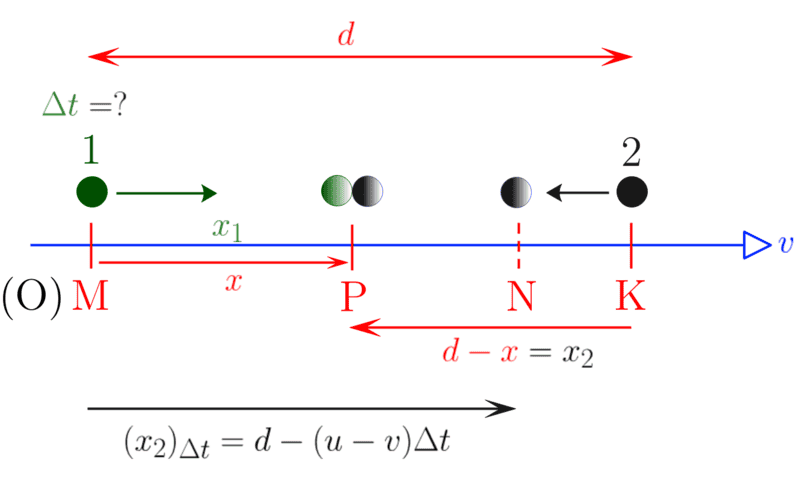

##(\rm{b}) -\text{1 leaving M after a time }\Delta t##
Launch 2 here travels for a time ##\Delta t## and is at a position ##(x_2)_{\Delta t}=d-(u-v)\Delta t## and arrives at N. If they both meet at P at a distance ##x## (from O or M), then the time taken by 1 ##\small{t'_1=\dfrac{x}{u+v}}##. This the same as the time taken by 2 to travel the remaining distance to P, ##\small{t'_2=\dfrac{d-(u-v)\Delta t-x}{u-v}}## which, after some algebra, simplifies to ##x=\dfrac{u+v}{2u}\{d-(u-v)\Delta t\}=x_1##. The distance covered by launch 2 ##x_2=d-x=d-\dfrac{u+v}{2u}\{d-(u-v)\Delta t\}=\dfrac{u-v}{2u}\{d+(u+v)\Delta t\}##, after some algebra.
The time for 1 forwards to meet : ##\small{t'_1=\dfrac{x_1}{u+v}=\dfrac{d-(u-v)\Delta t}{2u}}\quad (3)##. Likewise, the time for launch 2 forwards to meet 1 ##\small{t'_2=\dfrac{x_2}{u-v}=\dfrac{d+(u+v)\Delta t}{2u}}\quad (4)##.
Note that these times are different despite a "meeting" taking place., because launch 2 travelled for a longer time ##\Delta t##.
The time for 1 to return to his station M : ##\small{t''_1=\dfrac{x_1}{u-v}=\dfrac{u+v}{2u(u-v)}\{d-(u-v)\Delta t\}}\quad (5)##. The total travel time for launch 1 can be found by adding ##(3)+(5)##, which leads to ##\small{t_1=t'_1+t''_1=\dfrac{d-(u-v)\Delta t}{u-v}}\quad (6)##.
The time for launch 2 to return to his station K : ##\small{t''_2=\dfrac{x_2}{u+v}=\dfrac{u-v}{2u(u+v}\{d+(u+v)\Delta t\}}\quad (7)##. Hence the total travel time for launch 2 can be found by adding ##(4)+(7)\Rightarrow\small{t_2=t'_2+t''_2=\dfrac{d+(u+v)\Delta t}{u+v}}\quad (8)##.
But the two times are given to be equal, ##t_1=t_2\Rightarrow\small{\dfrac{d-(u-v)\Delta t}{u-v}=\dfrac{d+(u+v)\Delta t}{u+v}\Rightarrow \dfrac{d}{u-v}-\dfrac{d}{u+v}=2\Delta t\Rightarrow \Delta t=\dfrac{vd}{u^2-v^2}}\quad (9)##.
From ##(1), (2)## above, ##\small{\dfrac{d}{u-v}-\dfrac{d}{u+v}=3-\dfrac{3}{2}\Rightarrow \dfrac{2vd}{u^2-v^2}=\dfrac{3}{2}\Rightarrow \dfrac{vd}{u^2-v^2}=\dfrac{3}{4}}##. But from ##(9)## this is the value of ##\Delta t##. Hence ##\Delta t = \dfrac{3}{4}\,\text{hr}\Rightarrow\boxed{\Delta t= 45\,\text{min}}\quad{\color{green}{\Large\checkmark}}##

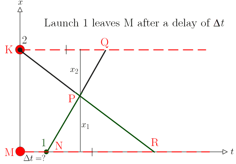

##(\rm{II})-\text{Graphical approach}##

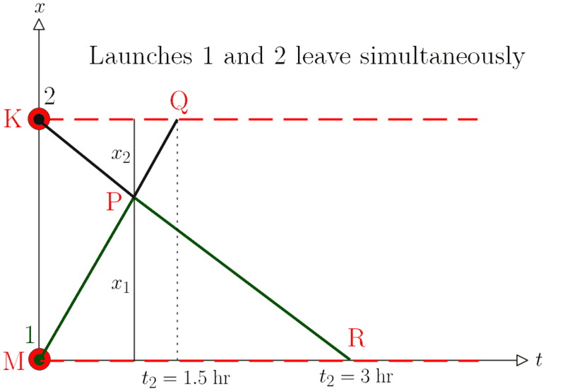

As before, there are two cases - when the launches leave simultaneously and when launch 1 leaves M after a delay of time ##\Delta t.##
Launches 1 and 2 leave stations M and K shown in red. They meet at even P and return to their stations. We are given launch 1 takes a total of 3 hours, so MR = 3, while launch 2 takes 1.5 hours, so KQ = 1.5. The triangles KPQ and RPM are similar. Since base MR is twice KQ, the distance to P (and back) must be twice by M as for K. Hence we have ##x_1=2x_2##. Thus 1's speed must be twice 2's speed : ##u+v=2(u-v)\Rightarrow u=3v##, where ##u,v## are the speeds of the launches and river respectively.
Here launch 1 leaves M after a delay, they meet at P and return to their landing stations. In doing so, it's given that they take the same times, so KQ = NR. Hence triangles KPQ and RPM are congruent, implying that distances ##x_1=x_2##, so they both meet midway between the landings.
I could not glean further information from the graphs in order to answer the question : what is ##\Delta t=?##

brotherbobby said:
I could not glean further information from the graphs in order to answer the question : what is Δt=?
Does it help to consider what it looks like if you rotate triangle NPR about the vertical axis through P?
By how much? A ##180^{\circ}## rotation would align NPR with QPK, both triangles being congruent.
Sorry, I was unclear. By vertical axis I meant the line through P parallel to KM.
Rotate 180°.
Rotate 180°.
Same response from me, I'm afraid, as before.
If you rotate ##\triangle## NPR about a vertical axis parallel to KM by ##180^{\circ}## it would coincide with ##\triangle## QPK.
Please let me know if am wrong.
brotherbobby said:
View attachment 345982Same response from me, I'm afraid, as before.

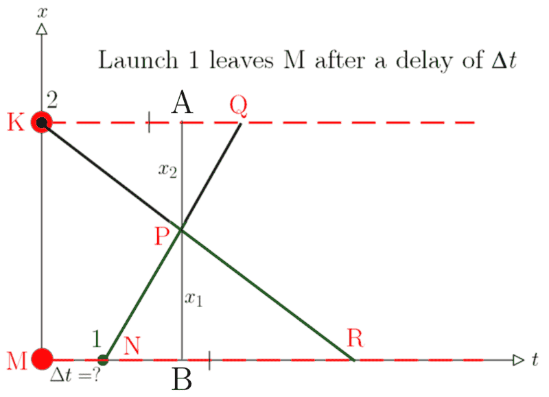

Rotate about the thin black line in your diagram, next to where you have written ##x_1, x_2##. R moves to M.
haruspex said:
R moves to M.
Why do you say so? I can't understand.
Of course RN = KQ.
(do you mean flip about the thin black line marked with distances ##x_1,x_2##?)
Yes, is that not what I wrote?
I suppose I'd like to clear this. Is rotation of a 180 degrees about the y-axis the same as a reflection about the y-axis? (It's a digression from the problem but an important point)
If it is a 2D plane being reflected or rotated 180°, they're the same.
For a 3D object, rotation 180° about the y axis is also the same as a reflection through the y axis ((x,y,z)->(-x,y,-z)) but is different from a reflection in a plane containing the y axis (e.g. (x,y,z)->(-x,y,z)).

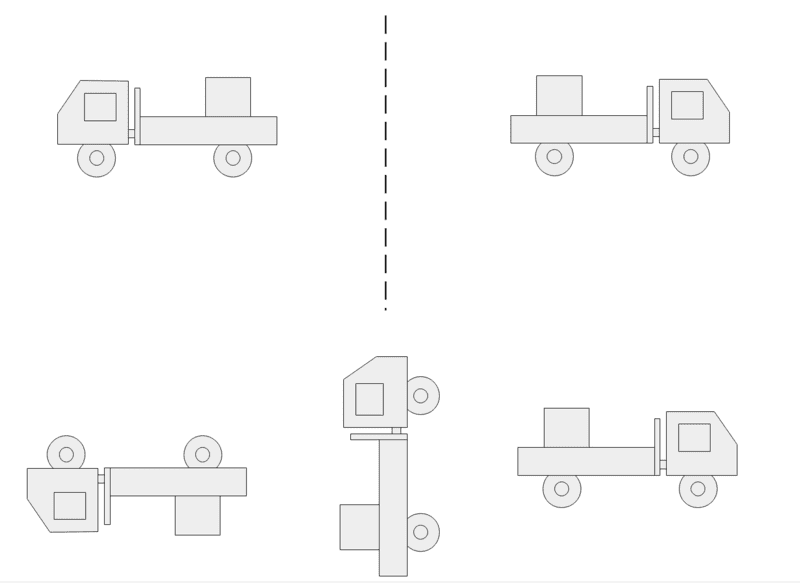

I'd like to share with you a demo I just did to verify what you said above. I took a toy model of a truck and subjected it to a reflection about the y-axis and then a 180 degree rotation counter-clockwise. These were carried out in a drawing software called ##\text{EdrawMax}^{\circledR}##.
Below are the results. The reflected truck and the rotated truck look different.
So I'd like you tell me what's going on here.
Your rotation is about the wrong axis. It should be about the dashed line. Think of it as a page in a book. Turn the page over.
Ok so I rotated about an axis going in through the page, perpendicular to it.
You're asking me to rotate about the dashed line, which is in the page. Got you. Yes I believe the two will coincide.
Ok to our problem. If triangle NPR is flipped (or rotated) about the vertical line AB, N will move to the right of B as far as it is to the left. R will move to the left of B as far as it is to the right.
N will come vertically below Q and yes, R will coincide with M. I agree with you.
How does it help in finding ##\Delta t##?
EDIT : The above means B is the midpoint of MR. That is all I could conclude.

You worked out the ratio of the two slopes, no?
Yes, the slope of NQ is twice that of KR.
haruspex said:
So what is the ratio NB:BR?
Sorry for coming in late.
Let's have the problem statement again.
Let's have the graphs again for the launches leaving simultaneously and the launch from M leaving after some delay ##\Delta t##.
Let's refer to the graphs as G1 and G2.
From G1, we conclude that ##u = 3v## where ##u## is the speed of the launch in still water and ##v## is the speed of the river. The slope of the line MQ is twice the slope of KR.
From G2, after flipping the triangle NPR about the line AB, R would coincide with M, making MB half of MR. Using the slopes of NQ and KR, we find BR = 2NB (from definition of slope = rise divided by run). These give MN = NB and so, we have ##\Delta t = NB=\dfrac{1}{4}MR##.
Question is, what is MR? Is MR the same in both graphs G1 and G2?
