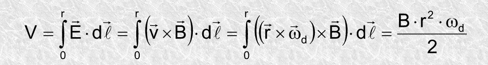

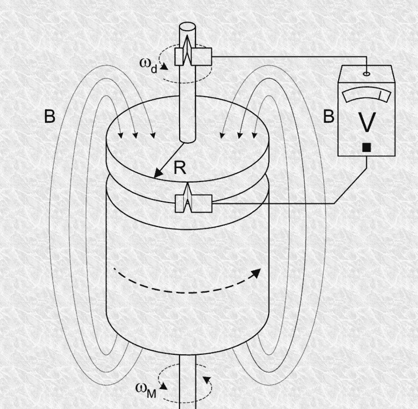

Give an expression for the induced current in a homopolar generator as a function of angular velocity ##\omega##
So I was searching up on the homopolar generator and found this explanation for the generator, as well as the proposed solution.
However, I don't really understand what the solution is trying to do here.
Ok, I understand to find the current, you will need the potential, which is the integration of emf. However, I'm stuck at the last part. How did they exactly derive ##dl ##and what is ##dl## exactly?
Any explanation will be appreciated. Thanks
Hi.
##d\mathbf{l}## is along the line between shaft and contact point. ##d\mathbf{l}## and emf working on the line have same direction, with plus or minus signature.
I think the integral "overloads" the symbol ##r## as it uses it both at the integral boundary (from 0 to r) and to denote the position vector along the path of integration which is along a radius R. I think it would be more proper to denote the ##\vec{r}## as ##\vec{l}## and then everything falls into place cause then ##d\vec{l}## gains its meaning inside the integral.
