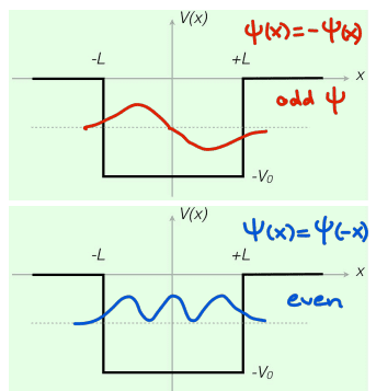

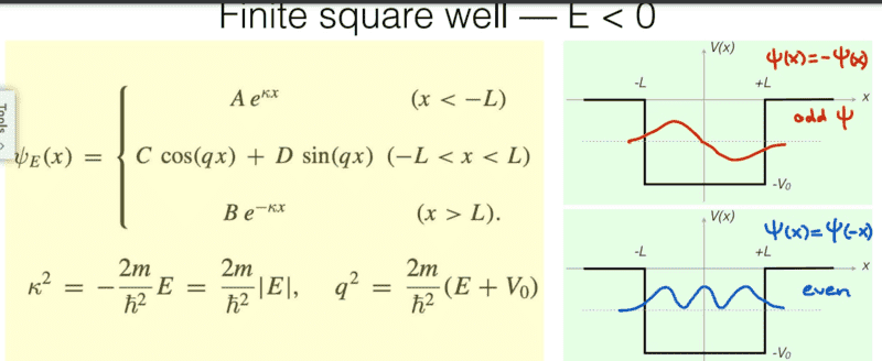

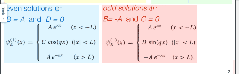

So I didn't get how professor make wave function to be odd and even and then magically solved them,..
None, it's non-analytical.
So
,solution only fit for one of them , the other one is not zero , how can that be solution??
I am pretty new to quantum physics..

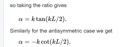

So, it is trying to solve this eqs

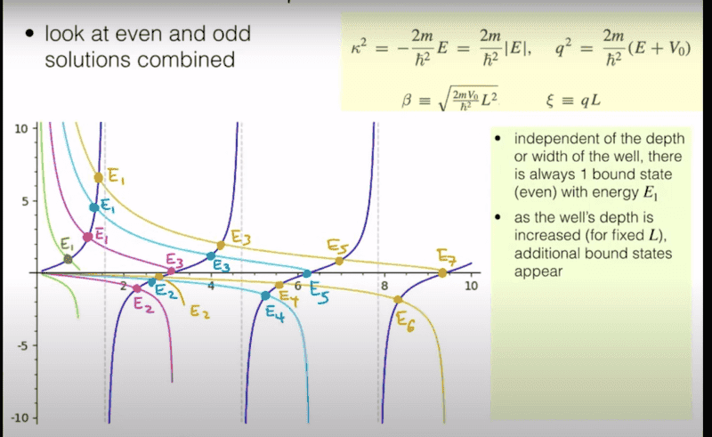

right, there are two variables , alpha and k, all related to E , so when this stands, there will be a valid E. the question is , the valid E for both of them are not stand together, how can there be "combined solutions"?

In one dimension there is always at least one bound state for any finite square well (and it will be the lowest symmetric state) . There may be many more depending upon the depth and width of the well.
You are trying to learn a big chunk of quantum in one bite here!
