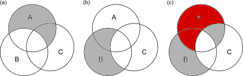

I am not sure if I am allowed to ask this, but here's my shot:
I find all the explanations of Bell's theorem summed up here, very different in interpretation and also (for me) incomprehensible. I have these simple questions:
How does the Bell inequality, stated as N(A, not B) + N(B, not C) ≥ N(A, not C), relate to the position of the detectors? Do A, B and C represent binary values or invertable continuous values? (What do they mean??) What is the most comprehensible source discussing Bell's inequality making use of this formula? (I fully understand the formula itself, but not its significance)
Put differently: in a Venn-diagram, what do A, B and C represent?
Thanks.

"A" would be the + outcomes of a polarization (spin) measurement at some angle a. "Not A" would be the - outcomes (note that + and - are arbitrary labels, you could also label it 1 and 0, or H and V).
So "B" would be the + outcomes of a polarization (spin) measurement at some angle b. And so on.
With an entangled pair, you can only measure 2 of the 3 angles at a time. So you would need to run a suitable number of trials of the 3 pairs: N(A, not B), N(B, not C) and N(A, not C). That would give you averages that can be plugged in.
For a classical example: You have a room with 100 people in it. The A group are men, Not A are women. The B group are parents, Not B are people with no children. C are right handed, Not C are left handed. So we substitute into the formula N(A, not B) + N(B, not C) ≥ N(A, not C) and get:
[1] N(men, not parents) + N(parents, left handed) >= N(men, lefthanded)
The classical version will always be true, no matter how you select the people to go into the room. That is because the above inequality, with suitable rearrangement, becomes:
[2] N(men, not parents, right handed) + N(women, parents, left handed) >= 0
I can explain how I got from [1] to [2] if you like.

I have made a Venn-diagram for the equation:
N(A, not B) + N(B, not C) N(A, not C)
Likes Jilang
How did I get from [1] to [2]?
Using ordinary classical assumptions, I expand as follows:
[3]
N(men, not parents) = N(men, not parents, left handed) + N(men, not parents, right handed)
N(parents, left handed) = N(men, parents, left handed) + N(women, parents, left handed)
N(men, left handed) = N(men, parents, left handed) + N(men, not parents, left handed)
Make sense? Using those identities, I substitute into the original [1] and get:
[4]
N(men, not parents, left handed) + N(men, not parents, right handed) + N(men, parents, left handed) + N(women, parents, left handed)
I notice that the 2 right hand side terms both also appear on the left hand side as well. So I eliminate them from both sides. This gives me:
[5] N(men, not parents, right handed) + N(women, parents, left handed) >= 0
QED. Now, keep in mind that the classical assumption I made in [3] is subject to attack in the quantum world. Precisely because classical logic fails there, and the inequality is not valid in actual experiments.
