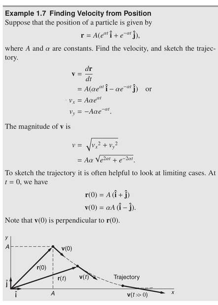

Hello! So, I was beginning to skim Kleppner and Kolenkow for an upcoming course I’m taking over the summer. I saw this on pg. 17 and was wondering if I’m making a silly mistake in understanding what the book is saying. When they take the derivative of the position function, isn’t the velocity wrong? For vx, shouldn’t the function be A(alpha squared)(e^2x)? Thank you!

Not sure how you came to that conclusion. Using the full expression for position write out the expression for the x-component of the position and derive from it the expression for the x-component of velocity.
It is useful to check units.
##A## must have units of position ##e^{\alpha t}## is dimensionless.
##\alpha## has units of inverse-time since the argument of the exponential function ##{\alpha t}## is dimensionless.
Thus, in your proposed expression,
##A\alpha^2## has units of position per time-squared (an acceleration)
and ##2x## (with units of position) can't be the necessarily-dimensionless argument of the exponential function.
As @Dragon27 says, it's unclear how you arrived at your expression.
