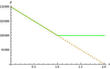

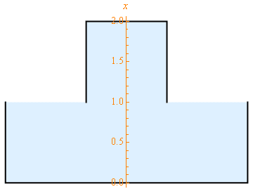

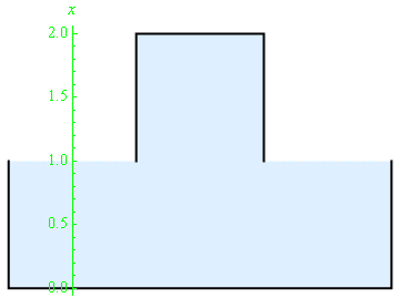

We are interested in pressure along green axis in the first picture and along orange axis in the second picture.
Air pressure is constant everywhere.
For the first case:
under water surface:
p = patm + ro.g.h
patm = 105 Pa = 105 kg.m-1.s-2
ro = 103 kg.m-3
g = 10 m.s-2
h = 1-x
above water surface:
p = patm
So we have
for 0 <= x <= 1: p = 100000 + 10000(1-x)
for x>=1: p = 100000
Graph for the first case is in third picture.
How is it for the second case?
