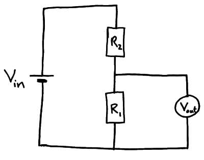

I've come across a booklet on understanding electricity, and it's been very interesting, but I've hit a rut! The packet says that the sum of the voltage drops of resistors equals the source voltage. How is that possible? Were the voltage to continuously drop, wouldn't no voltage exist at all once passing through the last resistor?

It is better to think of resistors as dividing the available voltage so that none is left over.
If you take a chain of say 3 resistors and put say 12 volts across the chain the 3 resistors will divide that 10 volts so that there is say {4volts, 4volts, 4volts} across each resistor.
Now say we add a fourth resistor but keep total voltage (remember your booklet called it the source voltage?)
Again the resistors divide the 12 volts but this time there is {3, 3, 3, 3} across each resistor.
The next step is to learn how we calculate what voltage drop is allocated to each resistor.
Notice I have not mentioned current. Learning about current is the step after that.
Studiot said:
It is better to think of resistors as dividing the available voltage …
here's a diagram of a voltage divider …
:wink:
