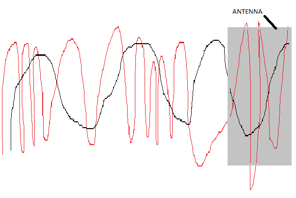

Ok, well I suppose could we PLEASE go over:
-If most don't resonate how is there a standing wave?
-Aren't standing waves bad? (because all the energy is being reflected back, or is that not true for receivers?)
-So if you've just got a conductor in the air, there is all manner of current in it (crazy mess) from all the different EM waves passing through it?
Edit- This picture is the type of thing I'm thinking of, what's going on inside the antenna (receiver) as far as voltages and currents?
How does the inductance and capacitance play a role?
Thanks

  • #66
You don't need resonance for a standing wave. If a wave is reflected at a barrier, the reflected wave will interfere with the incident wave and the resultant will be a standing wave as the relative phases change over the distance from the reflection. You are right to pick this up because most times you are told about standing waves, you are dealing with strings at resonance - when there are reflections at both ends and, when the spacing is right, the energy builds up in the interference pattern and you get resonance (But for friction losses, the amplitude would go infinite). If you take a short string, fixed at the other end, and waggle it from side to side. you will get a standing wave, even for a very slow oscillation but it isn't exactly obvious - except for the fact that the displacement of the string goes from max at your hand and zero at the other end. The shape of the string will be triangular for very frequencies but it will become more and more sinusoidal as you go faster, until you reach the resonant frequency, then the string shape will be a sinusoid.
This ties in with the images you have seen. Think of the wave along a short dipole as an interference pattern - min current at the end because the 'I' can't go anywhere!. If the dipole happens to be half wavelength long then the current will be in just the right phase to slosh up and down in time with the input signal and you will get resonance. Because the current is high, then this will couple best into a radiated wave. The antenna is 'matched' into free space and appears to be just a resistor of about 70Ω at the feed point aamof. The amplitude of the resonance is, of course, limited by the loss of energy into space.
You will, by now, be suffering from indigestion, I'm sure. There's an AWFUL LOT of this to take in.

If you've just got a conductor (an unused antenna) sitting in the air, with multiple EM waves going through it, are there multiple standing waves due to these EM passing?

The Peak to Peak voltage variations should be the same at all points along the line.
In pretty well every situation we are dealing with a linear system. The currents / waves along the antenna are a superposition of the effects of all the different passing EM waves. Multiple standing waves, if you like.

So they can sort of filter out different frequencies of this one, superposition-ed wave, with different circuits to use the same antenna for multiple signals at once?
  • #71
Of course. The same way that an antenna can grab a range of signals out of the air from a whole range of EM waves, then a selective receiver can filter out the narrow band of frequencies it wants to look at from a single antenna downlead. Just think of the many instances where a single antenna feeds a large number of receivers (blocks of flats with a distribution amp on the roof) and where a number of transmitters can feed into a single transmitting antenna (UHF TV transmitting stations).
Superposition's the thing.

How can an antenna have standing wave voltages on it, yet the charges don't 'resonate'?
So they're moving with the erratic signal, could you clarify what you mean? Maybe its the terminology 'resonate' that is throwing me.
Thanks

Current can flow without there needing to be any resonance. An electric field can cause charge to flow in an antenna just as it can anywhere else. There is also the Magnetic field that will be causing currents. Alternating in direction isn't the same as resonance.

You don't need a standing wave to pick up some energy from a passing EM wave. It's only a design detail to make it more effective.
Try this view of a dipole. If you have a two wire transmission line then a progressive EM wave can pass along it, bound to the two wires (this is how AC 'electricity' travels along wires). If you terminate the line with the appropriate resistor (the load) then the power is all dissipated in the load. If you terminate the line incorrectly (like an open circuit) then the wave is all reflected back (a nuisance, sometimes) and you will have a standing wave in it.
Now split the last metre or so of the line and separate the wires to form a straight line at right angles to the line (a dipole). You still have a transmission line and it's still terminated at an open circuit and you will still get a standing wave with NO CURRENT flowing at the tips. But there is still SPACE for some of the energy to be radiated into. This radiated energy 'looks' to the line like a resistance because Power is going somewhere. You can actually measure a resistance (an RF resistance, that is) if you connect an analyser / bridge / gizmo to the line and it's called (not surprisingly) the Radiation Resistance. But there is still a standing wave of current on the dipole and you will also measure a reactance across the line. By choosing the dipole to be a half wave long, the reactance goes to zero (that's your resonance). It isn't essential to resonate but you get a good 'match' if you do. All that remains to do is to choose your transmission line dimensions to have the same characteristic impedance as the dipole presents and all the power gets radiated. The dipole looks like about 70 Ohms so if the line is also 70 Ohms, Bob's your Uncle.
Most feeder is coaxial and not two wire (better isolation for the feeder) and you can commonly get 50 Ohm and 75 Ohm - not 70 Ohm. This is because of the way that real dipoles and real antennae are connected etc. etc. and you don't need to worry too much first time round about the discrepancy.
But the basic thing is that a dipole behaves very much like a continuation of the transmission line that feeds it.
