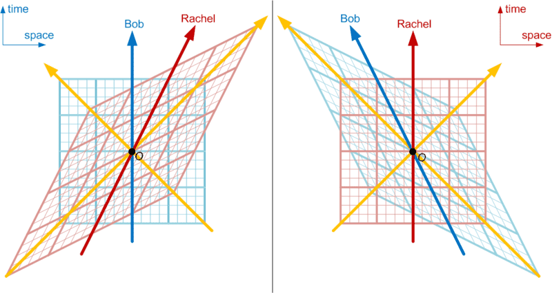

To help the discussion, here is exactly such a diagram. In fact, here are two views of the same diagram; one has been stretched and squashed relative to the other, but they both show exactly the same space-time content. Time is vertically upward and one dimension of space is horizontal. You can imagine a second dimension of space perpendicular to the diagram if you wish.
The red and blue arrows show the trajectories ("worldlines") of two inertial observers Rachel and Bob. The pink and blue grids are their respective space-time coordinate systems.
The yellow arrows are two photons traveling in opposite directions. Note that they have the same speed (i.e. their worldlines have the same gradient) measured in both the red and blue coordinate systems.
Discuss.

  • #70
Oh ... that's very nice - thanks. I put a link to another site in an earlier post on this thread (on the first page, most likely), which has animations showing how you go from one of these views to the other, but I don't think they can be embedded here.
