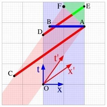

One more thing.
In ST diagram, shouldn't the picture rotated 90 degree?
Whether the time axis is up or sideways is just a convention; it's right either way. The time-vertical convention everyone here uses may be more common, but you'll often see the other one used, and it's not hard to make the mental adjustment.

Btw..
https://en.wikipedia.org/wiki/Ladder_paradox#Ladder_paradox_and_transmission_of_force
Axis' don't have to be perpendicular. They can be slanted like the red arrow t' and x'. Is this true?
Just a random question.
Is ladder paradox similar (perhaps not precise the same) as barn paradox?
Do ladder/barn paradox take the concept of the famous train experiment? Where the light from the front and the back of the train hits the center observer at the same time.

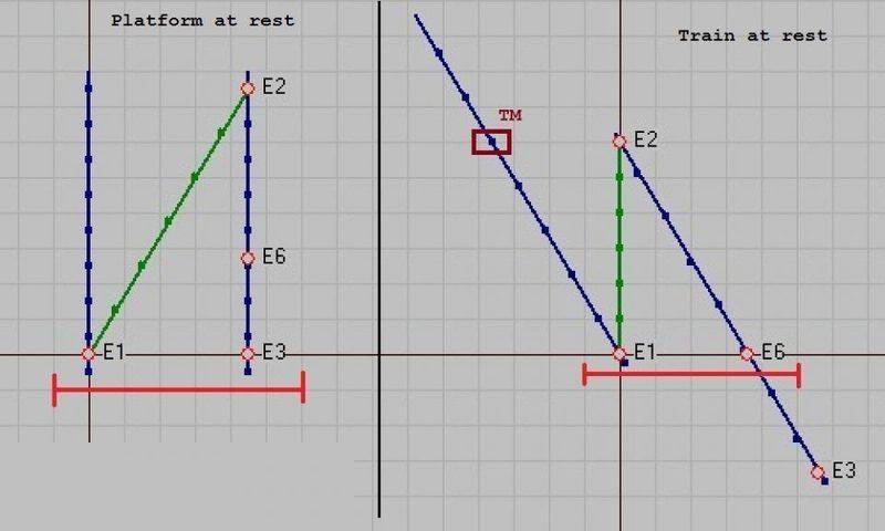

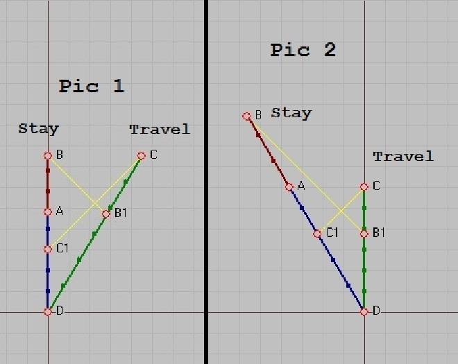

In 2D (1 time + 1 spatial) spacetime diagram, it would be a horizontal line. In 3D (1 time + 2 spatials) that would still be horizontal line. And in 4D?. Okay don't answer it. I'm trying to understand acceleration (X direction only of course) but I need to know the convention in SR first.
Nugatory said:
It would be agood exercise to try this for yourself on some of the space-time diagrams you've drawn - pick some points that are simultaneous in one frame but not another.
Are these what you mean? I have had before. Thanks.
Event C and A.
Event E1 to E6 or E3.
Event E2 to TM
I have a question:
Can Axis' be slanted, not perpendicular?
Many thanks for your help.
