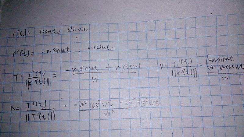

here it is .

Good thing I asked. In your ##\vec v## I can still distinguish an ##\hat\imath## and a ##\hat\jmath##, so they can pass as vectors. An alternative notation would be ##\vec v(t) = (-\omega\sin\omega t, \omega\cos\omega t)\ ##.
I'm not sure what you mean with ##V##, but if it's ##\vec r'(t)\over \|\vec r'(t)\| \ ##, then so far we have used the name ##\vec T##. Why not keep that name ? And: it is a vector, not a number !

V is not r'(t) ?what is V now? I'm confused...

How can you be confused about something you introduced yourself ? line 2 in your post has a ##v## (small v) but you mean a vector. Learn yourself to clearly designate vectors as vectors and scalars as scalars.
Line 3 has a ##V## big V (right ?) what do you mean with that ?

they should be the same v , by the way, what is ##v## ? i am still blurred.

  • #66

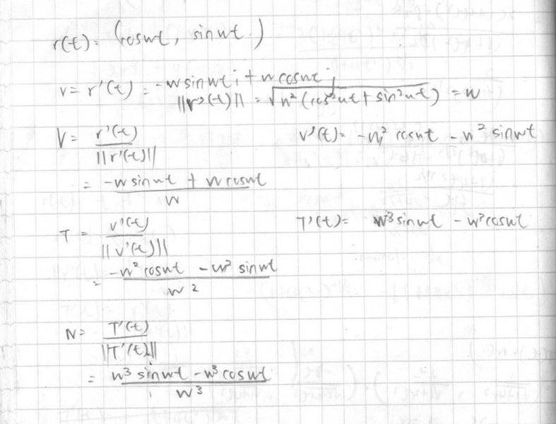

Ok, here is after correction
  • #67
So far
we have ##\vec r\qquad##
don't forget the arrow over the ##r## -- or some other way to clearly mark it as a vector
don't forget the brackets
##\qquad \vec r(t) = (cos\omega t,\sin\omega t)\ \ ## which was the given data.​
we have ##\vec r'\qquad ## which is ##\vec v## (so ##\vec v## is NOT your ## {r'\over|r'|} ## !)
don't forget the arrow over the ##r'## -- or some other way to clearly mark it as a vector
##\qquad \vec r'(t) = (- \omega \sin\omega t,\omega\cos\omega t)\ \ = \omega (\sin\omega t,\cos\omega t)\ \ ## .​
We see that ##|\vec r| = 1 ## (right ?) and we see that ##|\vec r'| = |\omega| ## (right ?)
But then you go all wrong by thinking that ##\vec T## is not a vector.
And what you do to find ##\vec N## is a mystery to me. Again, you write it as a number, which it is NOT. ##\vec N## is a vector !

  • #69
BvU said:
But then you go all wrong by thinking that ⃗T\vec T is not a vector.
And what you do to find ⃗N\vec N is a mystery to me. Again, you write it as a number, which it is NOT. ⃗N\vec N is a vector !
sorry , for T , it should be (-w sin wt i + w coswt j ) / w
, similarly ,
for N , it should be = (-(w^2)((coswt)^2) i - (w^2)((sinwt)^2) j ) / (w^2)

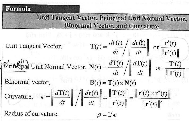

Again , here's the formula have in my book

  • #72
, similarly ,
Yes, so you have ##\vec T = \omega(-\sin \omega t,\cos\omega t)## and ##\vec N = -\omega^2 \vec r\ .\ \ ## Easier on the eyes...:rolleyes:
[edit] Oops! it's even simpler. See #77 for a corrected version...
------------------------------------And no need to repeat the formula in your book, that way we will end up with > 100 posts and many many pages ...o_O

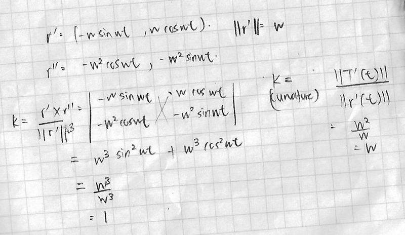

  • #74
BvU said:
No, I mean do you know the something in $$|\vec r'\times\vec r''| = |\vec r'| \;|\vec r''|\; \text{something} $$
well, here's my working...I didnt get the same ans though, which part of working is wrong?
i get w and 1 respectively when i used different approach...
  • #75
If you recognize ##\vec r = (cos\omega t, \sin\omega t) ## as describing the unit circle, you know which of the answers for ##\kappa = {1\over \rho}## is wrong ...
Check your own post #66...
And cry out that I made two huge mistakes in post #72 o:) o:) o:) -- sorry about that !

i still couldn't figure out which part is wrong, can you point out?
  • #77
A unit circle has a radius 1, so my guess is that the answer 1 is correct and the answer ##|\vec \omega|## is wrong. And I've found why and it's somewhat my fault because in post #72 I made two huge mistakes.
Note that we are doing two things in parallel: working out the simple example ##\vec r = (cos\omega t, \sin\omega t)## and make an inroad for your long-standing question as in post #1, #13 and #63.
I humbly fix #72:
So far we have the unit vectors (:smile:) ##\ \ \vec T = (-\sin \omega t,\cos\omega t)\ \ ## and ##\ \ \vec N = -\vec r\ \ ## Curvature is 1 and radius is 1.
In the more general case the acceleration was decomposed into a tangential component by means of projection . You did not have a problem with that step ? Because we are going to use that to understand the magnitude of the normal component "The second equalities will be left as exercises"
Likes chetzread

You mean k=(T't) /(r't) is wrong?

I don't know how to divide a vector by a vector. (or perhaps I intentionally misunderstand your notation :smile: )
Anyway, yes: that ##\kappa\equiv \displaystyle {|\vec T'|\over |\vec r'|} ## evaluates to ##|\omega|/ |\omega| = 1 ##.

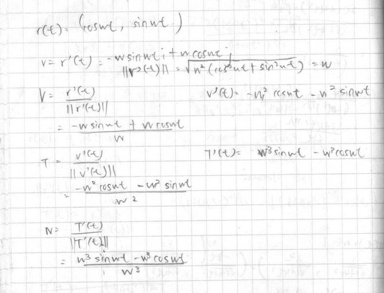

  • #82
BvU said:
No, not if ##\ \ \vec T = (-\sin \omega t,\cos\omega t)\ \ ##...
And:
Please please please become adept at using a sensible and consistent notation. ##\vec T'## is a vector. ##\omega^2## is a number. They can never never never be equal.
##\ \ \vec T = (-w\sin \omega t, w\cos\omega t)\ \ ##...
##\ \ \vec T' = (-(w^2)\cos \omega t, (w^2)\sin\omega t)\ \ ##...
why you left out w for ##\ vec T\ ##...
Here's my previous working
  • #83
In your working (I had seen it and checked it already) in the expression for ##\vec T## you can divide out the ##\omega## in the numerator against the ##\omega## in the denominator. (That way you also get a vector that clearly has length 1). Differentiate wrt time to get ##\vec T' = -\omega \;(\cos\omega t, \sin\omega t)## ...
The expression for ##\vec T## in your working may be right (apart from the incorrect notation), but
you should still correct your expression for ##\vec N##: it is not correct.

do you mean by cancelling off the w in the denominator and numerator ##\vec T##
and cancelling off (w^2) in the denominator and numerator ##\vec T'##
eventually, we get magnitude of ##\vec T## and ##\vec T'## equal to 1? k =1 ?
yes
No. You differentiate wrt time . See post #83.
Yes for ##|\vec T|##, beccause ##\vec T## is a unit vector.
No for ##|\vec T'|## because ##\vec T'## is NOT a unit vector. (but of course ##\vec N \equiv \vec T'/|\vec T'|## IS a unit vector !)
see the example. Very useful example !​
