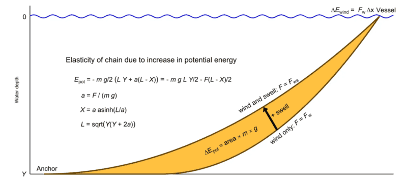

If the anchor catches on a rock or coral on the bottom and the ship is still in motion (forward or backward), then as soon as the chain becomes taught with ship's momentum versus anchor hold force producing tension. Unfortunately, chain has no elasticity to absorb shock. That shock force can be enough to yank the brake clear off the ship. Slippage in the brake in this case prevents the ship from trying to stop in near zero distance. So max brake force and slippage is a necessary property to allow for this contingency.
The ship should never be at a dead stop when the anchor is dropped, because after the anchor hits bottom and chain keeps coming, it would make a pile. Piles of chain can make knots or make loops around the anchor flukes; both very bad. The total length of chain, let's say 10 times water depth, needs to be played out as the ship moves. Ideally the chain should lie evenly distributed on the bottom in the catenary shape. So the first 1x water depth, the anchor falls by gravity. After that, 9x water depth more chain is pulled out by letting the ship drift with no propeller power. A runaway causes the chain to make a pile on the bottom.
Once full chain is deployed, the catenary curve give the whole system elasticity because chain needs to be lifted from the bottom before it forms a taught straight line. Most of the forces keeping the ship from further movement comes from the heavy chain lying on the bottom, not from the anchor. Vulnerability to sudden shock loads is highest when the anchor first touches down and the chain is nearly vertical.

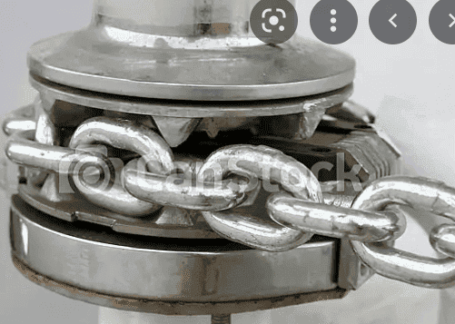

I forgot to mention. In existing systems, the chain goes through a capstan wheel. A much bigger version of the ones in the images. It plays the same role as a sprocket. The brakes act on the capstan wheel's shaft somehow.
Using friction or electromagnetic braking? Actively cooled with water? It doesn't look like it from the video...

Anyway. An additional point about those brakes: since the chain is supposed to be 'laid down' on the seabed, the ship is usually moving (albeit slowly) during a regular anchor drop. If the anchor got stuck after it reaches the bottom then those brakes are dealing with the mass and momentum of the whole ship, and not just with the chain itself...
No, after being set, the chain is simply being unspooled along the bottom, but stationary/with no tension beyond from its weight. There's no time when the ship has significant speed while setting/dropping the anchor, and no significant dragging occurs/is desired. The main problem would simply be dragging the anchor, not damaging the equipment. Also, the anchor can't be set if the angle is steep; it needs to be pulled horizontally. The scenario where an anchor is being dragged at significant speed on a short length of chain and then catches an obstruction would be very unusual.
And even for what it is, I don't see much chance for damage. It would require hard-setting the brake at a time when it has to be softly applied (otherwise the anchor wouldn't get to the bottom).

That'd be a start, but the runaway typically continues after the anchor hits the bottom. The chain is most of the weight. Maybe deployable sea anchors at regular intervals along the chain...
Yes, that's right. If the runaway speed exceeds ship speed, the fall becomes vertical, and the weight suspended depends on the depth of the water.
