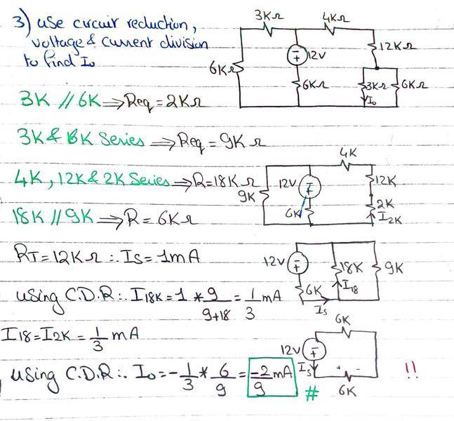

in the solution sheet, He took the 18 ohms parallel with the 9 ohms and not the 6 ohms. I don't understand why he took this approach. I was going to take 18 ohms parallel with the 6 ohms and find their equivalent resistance then I'll take the result in series with the 9 ohms and find the total resistance of the whole circuit.
I don't see those on the diagram
if you take a close look, you would see he took 18 parallel with 9 ohms and found their equivalent resistance.
I assume you are referring to the 3rd diagram ?
also' you are misreading
18k = 18,000 Ohms not 18 Ohms
and
9k = 9,000 Ohms not 9 Ohms
OK now that we have that sorted out :smile:
yes that's correct and the resulting value will be in series with the 6k Ohms resistor
but the 18k isn't in parallel with the 6k so your reasoning is incorrect
can you see why it isn't ?Dave

no i don't know why it isn't.
Are the voltages across 18k, 9k and 6k equal?
do you know the difference between series and parallel ?
which do you think it is and why ?
