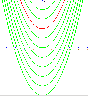

These are all functions of the form ##y\, : \,x\longmapsto x^2 +c## and thus they all have the same differential equation ##y\,'= 2x##.
This is nothing strange, because all these parabolas, or trajectories, have the same behavior with respect to slope (velocity) and curvature (acceleration). The only aspect which is different is the starting point, which we call initial condition. But differentiation doesn't care about starting points, only about derivatives, i.e. velocity and acceleration and so on.
So if we reversely only are given the differential equation, then we do not know which of the parabolas is meant.
The initial condition fixes this problem. That is, if we have e.g. as initial condition ##y(0)=4##, then only ##y(x)=x^2+4## is left as only solution to our differential equation. The initial condition quasi selected one trajectory among all possible, namely the one which crosses the ##y-##axis at ##y=4##, the third from top.

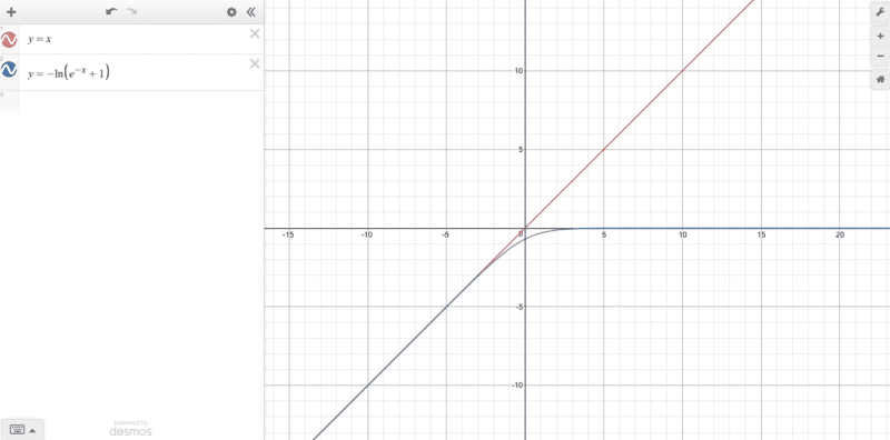

Ok this makes sense, but there are a couple of points of confusion for me.
The first, is that with these differential equations, some have the constant ##C## not as a ##+C## at the end, but sometimes inside of a function, or as a factor of something.
Take for example our ##y=-ln\left(e^{-x}+C\right)##
If ##C=0##, we have a straight line ##y=x##. But if ##C=1##, the graph is drastically different.
You get a constant for every integration you proceed, which hasn't explicite boundaries. So sometimes there are more than one "C". It is only then inside another function, if the integration took place earlier and there have been other algebraic manipulations. It is probably a factor, if it was formerly in an exponent, e.g. ##e^{x+C}## and ##e^x\cdot C## are the same. Of course the second is ##e^C## but this doesn't matter: an arbitrary constant is an arbitrary constant. The only difference is, that the latter can theoretically be negative, but if it came from ##e^{x+C}## then the initial conditions, which we use to fix the constant, will reveal that it is positive, or otherwise there is an error somewhere.
Likes opus

Yes. It is ##+C## simply because the derivative of it is ##(+C)'=0## and we cannot distinguish anymore.
Have a look at the parabolas in post #8. All have the one equation ##f\,'(x)=2x##. Now the an anti-derivative is ##f(x)=x^2##.
But what about all other parabolas which are also a solution to ##f\,'(x)=2x\,?## How can we know, that especially ##f(x)=x^2## is meant?
The answer is, we can't! So we have to consider all solutions ##f(x)=x^2+C##, since ##(x^2+C)'=2x## for any ##C##. And only then we have all possible solutions. We need an additional information to pick a certain solution out of all allowed ones.
Here you could say: The solution is in red. But as we normally do not have graphics, we prefer to say: the solution has to pass a certain point, e.g. ##f(-2)=8##. This also determines the red parabola. It is called an initial condition. The term comes from the fact, that you can consider those parabolas as paths where you can flow along. Then which of all those paths you take, depends on where you start - the initial condition: ##(x,y)=(-2,8)##.
It is with initial value problems that the ##C## can be dispersed throughout the equation because after we've found the anti-derivative, with a ##+C## at the end, we then need to solve for ##C## and do so by algebraic manipulations which is the cause of ##C## being throughout the equation.
