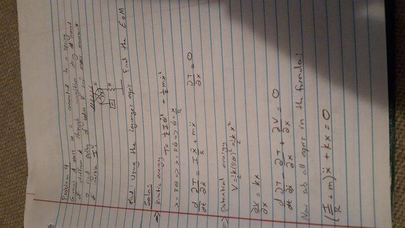

derive the equation of motion of a mass-spring-pulley system using lagrange's equations. A mass m is connected to a spring of stiffness k, through a string wrapped around a rigid pulley of radius R and mass moment of inertia, I.
kinetic energey
T = 1/2 (m)(x_dot) + 1/2 (I)(theta_dot)
potential energy
V = 1/2 k(R)(x)
sorry for the sideways picture... don't know why its doing that. but please help homework is due tomorrow morning! thanks!
What is your Lagrangian? Without writing it down, you will not be able to derive the equations of motion.
It seems your generalized coordinates are x and θ. Is there a constraint relating the two?
ts the second to last equation on the picture, with the partial derivatives to the respect of x. so ∂T/∂x⋅ - ∂T/∂x + ∂V/∂x = Q
and i believe there's a onstraint of x = rθ
That's not the Lagrangian. The Lagrangian is L = T - V. What you have is the equation for generalized coordinate x. You need to write another such equation involving θ and apply the constraint relating x and θ to get a single equation of motion.
