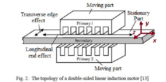

  1. The efficiency of Linear Induction motors seem low. This is in part because of gap between primary and secondary. At this point I could not distill the main results from literature.
  2. Two different track designs are possible. First carries current/energy as a part of the tube/track structure. Second uses a simple aluminum tube, with structural supports. There are different trade offs, in terms of pod cost vs track cost.

You can use a double sided Linear induction motor, with battery on the vehicle.
Lots of details I don't understand, It's a sufficiently complex problem. But I believe(subject to further analysis) it is one of the cheapest flexible and lightweight point to point infrastructure you can construct.

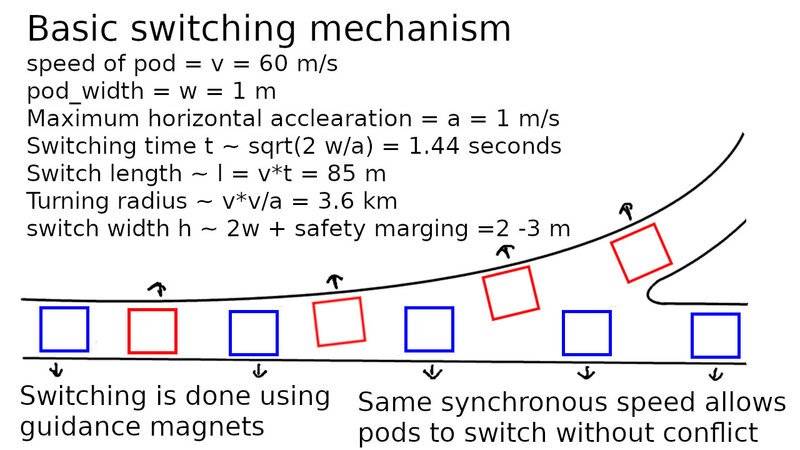

Are you out of your mind? Suppose a pod is 8 feet long. It's probably more. Suppose you need one foot between pods. It's probably more as well. 9 feet x 60 /s = 540 ft/s. That's 370 miles per hour!
A minimum turn radius for a railroad is 410 feet. That's 22 g's on a turn. Do you want to kill your passengers?
A minimum turn radius for a railroad is 410 feet. That's 22 g's on a turn. Do you want to kill your passenegrs?
I had assumed it was 1 meter long, because it seats only one person, and they are attached to each other.
You can change the assumptions. If you want 9 feet ~ 3 meters, you can get 20 pods per second. Or 20*60*60 = 72000 pods per hour. Which is still good for an urban setting. Especially because you can stack the tracks vertically and horizontally.
I am thinking of a design which comes as close to a chair on a track as practically possible.
I am imagining 60 m/s on straight tracks. If you want to turn you need to lower the speed significantly.
For instance Chou Shinkasen has a minimum radius of 8 KM. If you are looking at 410 ft ~ 125 m you need to lower the speed to something like 20 m/s.

No, everybody has to lower their speed significantly.

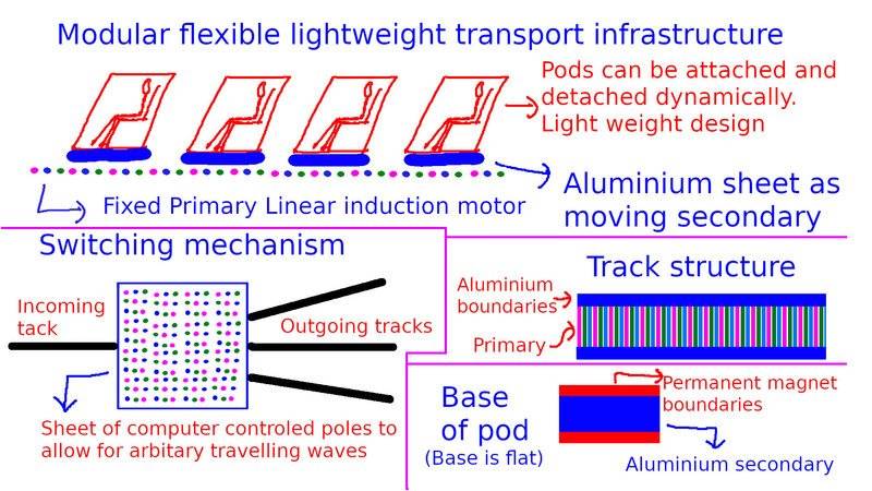

Even if a single track can carry 7200 pods per hour, such a system could makes sense. That's pods separated by 10m traveling at 20m/s. You can easily build many such tracks by stacking if a particular route is very busy.
The track are light weight, and you are not trying to carry many thousands of tons of weight, that is main argument. This coupled with modern computer electronic switching systems can make a compelling case, for flexible dense infrastructure.

This is what I have in mind currently. It can be designed in many different ways.

I will consolidate main points into this post. If there is anything I did not address, please let me know. The numbers can be significantly refined, corrected and revised.
In am looking at some variant of the design outlined in post 15.
  1. Vehicle Weight overhead Transport infrastructure comes with a weight overhead, starting with weight of the vehicle to weight of loaded tracks.
    A ball park estimate for a 12 train carriage+Engine weights ~ 100+12*20 = 340 tons, assuming 5500 passengers per train you have a weight overhead of ~60 KG's. (estimates vaguely based on Mumbai local network at rush hour)
    That's an optimistic estimate. And it may be closer to 200+ KG's in many real world implementations.
    I think pods weighting under 60-80 KG's should not be hard to design. In the most basic sense it's a chair on an aluminum secondary with added details.
    The exact number of passengers per vehicle is an optimization problem. PRT have been designed with different low numbers(1,2,4,6... etc.). One passenger per pod offers most flexibility, and lowest air drag. Other values could be considered, increasing it too much increases cost of supports, and reduces flexibility.
  2. Track and support weight overhead Same concept as above, the lighter your system lowers the cost. I don't have estimates, but max load per m is a useful metric.
    Cheaper the track, more densely you can lay. Reaching a density of 1 station per sq. KM in a city with population density of 10,000/sq KM is a useful milestone. Assuming you require 10 KM per sq KM of area. Each person pays for 1 m of track and 10000 people share a station.
    Traffic could be better balanced if the network is densely laid out.
  3. Motor cost This is an important expense. You can reduce the cost of copper coils required by lowering thrust and lift requirements and keeping it to a minimum.(something I need to estimate better)
  4. Radius of Curvature On sufficiently straight tracks speed is limited by aerodynamic drag and magnetic drag. On curved tracks speed is limited by human limits for acceleration.
    For max acceleration of 1 m/s^2, and max velocities of 5m/s 10m/s, 20m/s, 30 m/s and 60m/s the radius of curvature is 25m, 100m, 400 m, 900m and 3.6 KM. Managing the transition between different types of tracks with different maximum speeds is a switching problem.
  5. Pod gap and throughput per line In limit of perfect switches, the throughput per line is given by d/v_max. Where d is separation between pods and v_max is the maximum allowable speed on a track.
    d can range from ~ 1 m (limit of attached pods) to upto 10 m or so . Throughput can be suitably estimated.
    If one uses extreme assumption of d = 1m and v_max = 60m/s on straight tracks we arrive at throughput of .2 million/hr. Achieving numbers close to that is a marvel of technological precision and not at all easy.
    A reasonably achievable estimate would be, 20m/s and pod separation of 4m. That gives a throughput per line of 18000 pods per hour.
  6. Throughput of switches Seamlessly integrating tracks of different throughput and building a high throughput switching system is a challenging task. Having mechanical switches operating at 5 pods per second is likely not viable, mainly because of friction and single points of failure.
    The main task of the switching system is to seamlessly join multiple tracks of low throughput into a single track of high throughput and separate single track of high throughput into multiple track of low throughput. In most contexts throughput is mainly determined by v_max of track.
    I am suggesting (a possibly novel?) use of a 2 dimensional array for electromagnets, that is capable of producing arbitrary traveling waves. This allows for each pod to controlled individually and guided to it's track without losing speed. This is something that needs to be designed, but should be possible in principle with user of computer electronics. (currently thinking about this, will explore this idea in a later post)

There are 2 main technical questions that are worth examining to evaluate the proposed alternative. Maglev tracks are a well researched technology.
  1. What is the maximum throughput of the switching mechanism? Can it be designed without points of mechanical failure? ex using a 2d version of Maglev track, and creating arbitrary traveling waves. I believe 20000 pods per hour is an achievable target.(possibly much higher too)
  2. What is the estimate for the cost savings involved with because of light weight design. Both support cost and cost of electromagnets.
Vanadium 50 said:
If I have a 2km trip at 170 mph (Shinkansen-level speeds) but need to add 8km to the trip to handle the turns, wouldn't it be better to go straight and slower?
You are misunderstanding the system I am outlining. You have a combination of tracks with low and high curvature. Low curvature tracks are typically for long distances. These tracks fork using a suitable switching mechanism into multiple tracks of lower throughput and vice versa. Once your are on a track with lower throughput you can safely decelerate and turn. That is why I keep emphasing on the switching mechanism.

You can consider a wheeled design, but a system without mechanical friction has fewer points of failure and low maintenance costs.
I am not sure about efficiency, linear induction motors don't seem to have particularly high efficiency values because of end effects and air gap ( though anything above 50 pc is good enough for the purpose)

I am not entirely sure, if it is prohibitively expensive. I will make an estimate. This is just a first attempt at arriving at such an estimate. I could be way off ( please correct me or if miss basic points).
Say we use some type of permanent magnet linear synchronous motor setup and we have Neodymium magnets(which produce about 1 tesla of magnetic field) attached to bottom of the pod.
For the motor if we use copper winding around permaalloy or similar material. If my estimate is correct, primary thickness should be under 1 cm. The density of materials of roughly 9g/cc. And primary width is 1m. We have a motor weight of 90 kilos per m. Permaalloy seems to cost like 30 USD per KG. So assume cost of motor is 2700 USD per m.
This should suffice to lift a 500 KG loaded pod( base of ~ 1 sq m).
Say it requires 400 KG of steel per m to support it. Add ~800 USD per m. For a total loaded weight of 1 tonne per m.
Say total cost is 5 million per KM after labor, electronics, switching mechanism and miscellaneous. This is a very very rough estimate.
New York has an area of 784 Sqkm. Assuming 10 KM of track per Sq Km. You get a number of 40 Billion USD. New York GDP is 1700 Billion. That's 3pc of its GDP. NY is one of the riches places in the world, but even if its 10 pc of GDP, it can be built in a modular fashion over many years.
My estimate seems be in ball park of Skytran costs, quoted at 8 million per KM in 2015 prices.
