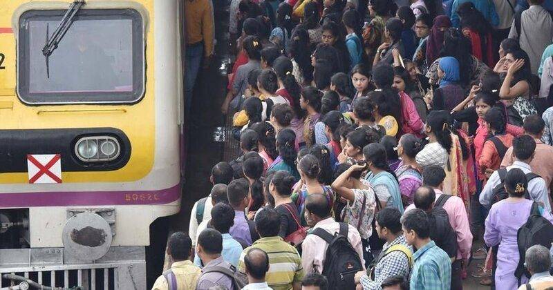

Vanadium 50 said:
All we really know is the answer is PodZ. The question is whatever it needs to be to have PodZ as the answer.
This is what 100k passengers per hour looks like in Mumbai local.

Vanadium 50 said:
Then you pivoted to "But Mumbai trains are so crowded!"
(By the way, there is a straightforward solution to that. Buy more rolling stock)
Mumbai metro pretty much runs at max capacity during rush hour. They use roughly 15-20 trains per hour each carrying like 5-6K passengers. That's great its does what it does well, and pretty much the life line of the city. They try to add more lines, but space is difficult.
