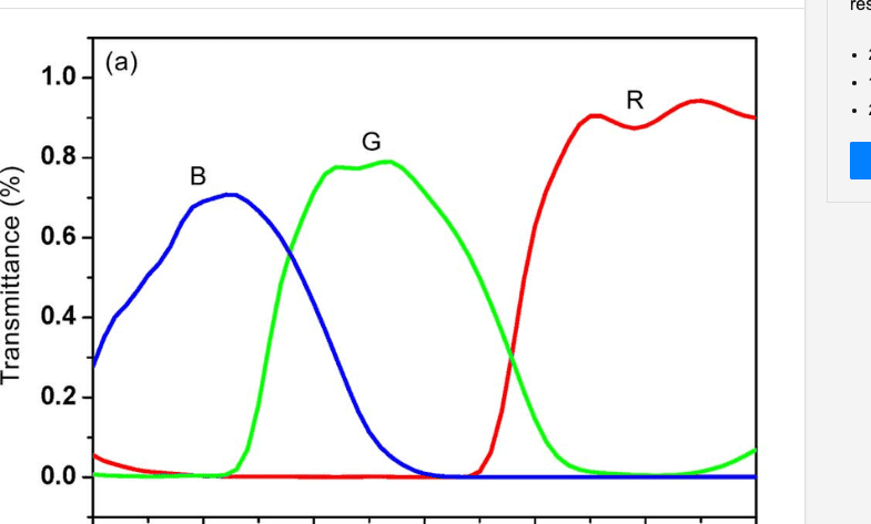

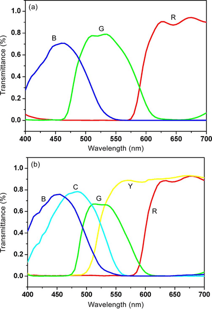

You would need to define what you mean by "accurate". The present TV (and other) systems can reproduce 'accurately' colours which lie within the gamut of the RGB primaries on the screen under the right conditions. Filters are available with many different characteristics (in cameras etc).
You have to consider the fact that a good colour reproduction system has to deal with all spectral content over a continuous range of wavelengths . You cannot have gaps between the filter passbands or you could lose some wavelengths. It is impossible (a practical problem) to produce three analysis filters that have 'rectangular' passbands. Hence they use filter characteristics which overlap each other. The filters are similar to the responses of the human eye sensors.
The components in the overlap are 'processed together' and the result gives a flat response over the whole visible range when recombined on a TV display. Try starting with this wiki link.
A diifferent set of filters may be used for astrophotography; some of the filters are very narrow band for picking out particular spectral wavelengths.
