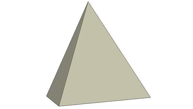

russ_watters said:
my house ... only has 3 walls and not many windows
Something like this, Russ? :eek:
Likes russ_watters
That's four walls and no roof. My house has a roof and three walls. :biggrin:
