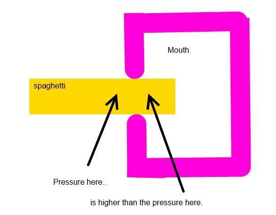

Returning to the OP. The question was about shape.
Consider a circular opening in a wall with a pressure difference across the wall. If the opening is plugged with a small disk, we easily see the force pushing the disk through the opening. The question is if we plug the opening with a long cylinder how does it get pushed through the hole. The forces on the sides of the cylinder do not push the correct direction.
I think the OP's instinct is correct. If the hole is plugged with an infinite straight cylinder there is no force pushing the cylinder through the hole. Therefore the reason we can slurp spaghetti is either because it is not infinite, or because it is not straight.
It is easy to see how any finite straight cylinder still gets pushed through due to the pressure on the ends. However that doesn't answer the question for a long strand of spaghetti.
I think the trick is to consider a bent piece of spaghetti. Suppose we have a cylinder plugging the opening, but the cylinder is bent to have a straight section through the opening and then sharp 90 degree bends on either side. Now once again we can easily see the unbalanced force. Of course real spaghetti won't make exactly that shape, but any amount of bend has a similar result.
So unless your spaghetti stays straight and is infinitely long it still gets sucked through the hole.

This has nothing to do with axial pressure forces on the spaghetti. There is a small annular gap between your lips and the strand of spaghetti. Air is being sucked into your mouth through the annular gap. You can hear this air flow when you are sucking in the spaghetti. The air that is being sucked in through the annulus creates a viscous shear stress on the spaghetti, tangent to its surface. This provides the force to drive the strand into your mouth.
Likes CivilSigma, TheCanadian, Tazerfish and 8 others
That sounds reasonable. However, I don't do that and the spaghetti still goes in.

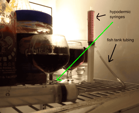

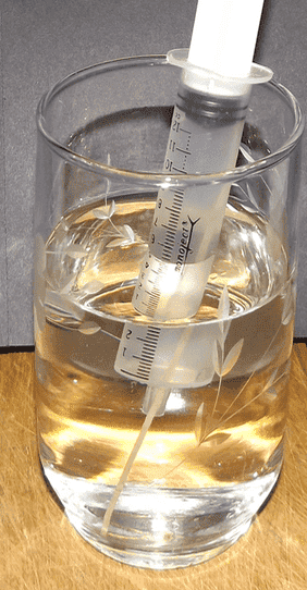

I tried to produce an experiment, both last night and this morning, as your assertion struck me as incorrect.
Last nights experiment ended poorly, as I wasn't able to insert my noodle into my "non-mouth" orifice, and, like the time I was going to disprove "bananas are yellow", I ended up eating my experiment.
This morning's attempt ended up as usual, with me:
a: hurting myself: spaghetti is hot!
b: getting very angry: this syringe does NOT mimic my mouth!
c: thinking: I need two jello type apparatuses
d: digging through the cupboards: only to find my jello-molds are the wrong size...​
But, I did find some test-tubes. And I know where to buy jello.
Videos of experiment attempt #3 at 11!
Likes Andreas C, Low-Q and Drakkith

OmCheeto said:
I tried to produce an experiment, both last night and this morning...
With Jello!
again...
, as
Jello makes for a very poor noodle.
again
Though this time, I decided eating A LOT of Jello for breakfast was a very poor idea.
Yesterday's attempt ended up as usual, with me:
a: shooting jello out of some fish tank tubing, which bounced off the ceiling, and leaving remnants scattered around my kitchen*
c: thinking, I need to think about this some more
d: discovering that it's nearly impossible to get gelatinized jello out of a test tube, without destroying your jello noodle
Videos of experiment attempt #4 at 11!
*This might make an interesting high speed video for @Andy Resnick . It was quite explosive, once the pressure exceeded the adhesive force of 'jello' to 'fish tank tubing'.

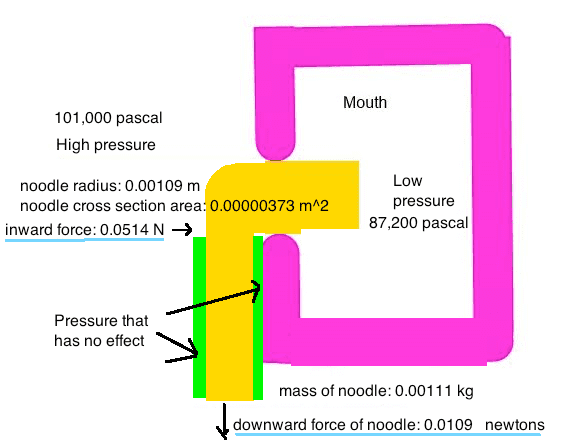

I'm still not convinced.
I borrowed CWatters' image, and thought about a limp noodle, and did some measurements:
Since the pressure differential creates a net inward force that is greater than the downward force on the noodle, I still think it will go in.
Another thing I tried before my failed jellomakesabadnoodle experiment, was cook a piece of spaghetti inside one of my syringes.
(before cooking)
It was a complete success, up until the moment I tried to partially eject the noodle, at which point, the noodle shot across the kitchen.
But I think that is reasonable evidence that only a pressure difference is required for trans-lip noodle transport.
ps. It should be noted that I have NOT succeeded in proving anything.
pps. I think I will buy some gummy worms tomorrow, as noodles and jello are no longer my friends.

But you omitted the viscous drag from the inwardly-moving fluid. I'm not in my office so I don't have a good reference handy but as best I can do here, the shear stress per unit length acting on the noodle will be approximately given using the lubrication approximation, resulting in a viscous drag on the noodle as F ≈ 4/3πr h ΔP ≈ 0.05 N using the numbers you posted above and 0.1mm for the film thickness. Plus, you can increase the pressure difference and use your tongue to assist.
From an axial force balance on the air between your lips and the noodle, I get ##F=\pi rh \Delta P## for the drag force, for the case in which the noodle is held on place and not moving (i.e., noodle held stationary by applying axial tension from outside). So your estimate for a moving noodle with less external axial tension seems reasonable.
