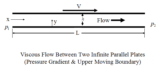

Vacuum or pressure to move spaghetti through a hole
In summary: The pressure difference across the hole should still be strong enough to push the cylinder through even if it is circular.In summary, the reason spaghetti can be sucked into a person's mouth is because the outside air pressure is greater than the pressure inside the person's mouth.

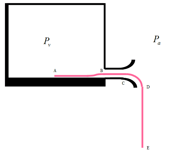

Over the past several days, I have spent lots of time thinking about this problem, and I would like to present what I have come up with. My focus has been on addressing the questions that @Stephen Tashi has been asking, and on using a solid mechanics approach of the type that @Andy Resnick has been recommending.
The analysis considers a cooked spaghetti noodle, and neglects its bending stiffness; so it is treated as being very flexible. The component of the gravitational force perpendicular to the noodle axis is neglected, but the component of the gravitational force tangent to the noodle contour is included. So the stresses in the noodle do not vary over its cross section. The force balance on the noodle is confined to consideration only of the tension and stress variations in the direction tangent to the noodle contour.
The principal stresses are locally approximated as being oriented in the tangential (axial) direction ##\sigma_z##, the radial direction ##\sigma_r##, and the hoop direction ##\sigma_{\theta}##. We employ Hooke's law in 3D to describe the deformational behavior of the noodle material, and to analyze the state of stress and strain in the noodle:$$\epsilon_z=\frac{\sigma_z-\nu(\sigma_r+\sigma_{\theta})}{E}$$
$$\epsilon_r=\frac{\sigma_r-\nu(\sigma_z+\sigma_{\theta})}{E}$$
$$\epsilon_{\theta}=\frac{\sigma_{\theta}-\nu(\sigma_r+\sigma_{z})}{E}$$where ##\nu## is the Poisson ratio and E is the Young's modulus. In our system, because of cross sectional symmetry, the cross sectional stress distribution will be transversely isotropic, such that $$\sigma_{\theta}=\sigma_r$$ and $$\epsilon_{\theta}=\epsilon_r$$ This enables us to eliminate the hoop stress and hoop strain from the analysis to obtain:
$$\epsilon_z=\frac{\sigma_z-2\nu\sigma_r}{E}$$
$$\epsilon_r=\frac{(1-\nu)\sigma_r-\nu\sigma_z}{E}$$
I've used the following diagram to analyze the problem:
The room atmospheric pressure outside the mouth is ##P_a##, and the reduced pressure inside the mouth is ##P_v<P_a##. So the pressure difference ##P_a-P_v## supports the component of the noodle weight tangent to the noodle contour.
Four sections of the noodle are identified in the figure. Section AB is entirely within the mouth, and does not support any weight; the pressure acting on the surface of the noodle is isotropic and uniform at ##P_v## in this section. Section DE is outside the mouth and is oriented vertically; the tension in the noodle varies axially in this region, although the pressure on the external noodle surface does not vary from ##P_a##. Section CD is also outside the mouth, and is contact with the lower lip (but not the upper lip); so the contour is curved, and only a fraction of gravitational force acts tangent to the contour. In section BC, the noodle is in contact with both lips, and the pressure on the noodle surface varies from ##P_a## at location C to ##P_v## at location B.
I think I'll stop here for now and continue in my next post. Please let me know if you prefer for me to analyze this problem in terms of absolute pressure and stresses, or in terms of absolute pressures and stresses.

  • #66
My personal preference is that you first analyze the simpler case of horizontal rigid rod (an uncooked stick of spaghetti). I suspect that if we try to represent "pressure" as family of arrows that push against the rod perpendicular to its surface then we must assume that the vertical surfaces at both ends of the rod are exposed to pressure in order to arrive at a component of force in the horizontal direction.
If we have a curved piece of spaghetti or a curved rod then forces perpendicular to its curved surface can have horizontal components. In that case, it is not mysterious that "pressure" can exert forces that push the rod into the mouth.
Your analysis takes for granted that the pressure differential produces a horizontal component of force. I believe it does, but my interpretation is that the original post is asking for an explanation of how it produces a horizontal component of force.
It's amusing (and perhaps a choking hazard) to consider a variation on the problem. Physics labs usually have sets of cylindrical brass weights. Suppose "the class clown" experiments with the weights by trying to suspend them off the ground by sucking on them. He looks directly down at the floor and, with the weight in his mouth, he sucks on it to keep the weight from falling. Then he tries the experiment on other objects - pieces of string, pencils, lengths of copper wire etc.
I wonder if the results such experiments would agree with calculations based on elementary mechanics. More weight would make things harder to suspend, more cross sectional area would make them easier to suspend. The trade-off between these aspects could be studied. For example, what is the longest length of bare #14 copper wire that the class clown can suspend by sucking on it?
Class clowns often outwit simple models. We might have to resort to your viscous flow model to explain things.

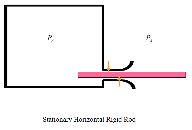

I'm going to take your advice, and first analyze a horizontal rigid rod. Then I'll move to a model of a vertical rigid rod. Then finally I'll model a flaccid spaghetti noodle.
First let's consider the case of a stationary horizontal rigid rod held in place by your lips.
In this case, no pressure differential is required between your mouth and the outside atmosphere. Your lips must merely apply an upward force to the rod to balance its weight (not shown in the figure), and they must also apply a moment to the rod (shown in orange as a couple) to prevent it from rotating.

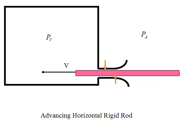

Let's next consider the case of a horizontal rod advancing into your mouth with velocity V.
In this case, a pressure differential is required to balance the viscous shear stress between your lips and the rod, given by Newton's law of viscosity: $$\tau=\eta\frac{V}{h}$$where ##\eta## is the fluid viscosity in the annular gap and h is the annular gap opening. The pressure difference is related to the shear stress by:$$(P_A-P_V)\pi r^2=2\pi r L\tau$$where r is the radius of the rod and L is the length of contact of the rod with your lips. So, combining these two equations, we get:$$(P_A-P_V)=\eta\frac{2 L}{r}\frac{V}{h}$$ (There is a additional air flow between the outside atmosphere and the mouth required to sustain the pressure differential, i.e., to provide the seal, but this air flow is small)
In the case where there is a pressure differential, note that the two ends of the rod do not have to be flat. Even if the ends are rounded, the net pressure force is still ##(P_A-P_V)\pi r^2##.
Comments about the horizontal rigid rod case?

The spaghetti is a passive player; all the action is created by the film of moving fluid.
Thanks Andy. To me it is clear that this problem involves a coupling between the solid mechanics and the fluid mechanics. I have carried out the hydrodynamic lubrication modelling that you have suggested in the above post and, for a rigid horizontal rod, have obtained the result I indicated in post #67:
$$V=\frac{rh}{2\eta L}\Delta P$$
Note that, for this case, the "pressure flow" component of the lubrication flow is negligible compared to the "drag flow" component.
I plan on continuing the analyses, first for a vertical rigid rod model and then for an actual flexible noodle model (where the solid mechanical part needs careful consideration). I'm confident that, when you see the details of the analyses, you will be happy with what I have done.
Likes DaTario and Andy Resnick

I believe the fluid involved as a lubricant must be the sauce. The lip-seal against the spaghetti allows some sauce to enter with the spaghetti. If too much sauce enters, then a lubrication seal failure will occur allowing air to enter, making the characteristic popping sound, suggesting answer A.
It is necessary for the experimenter to dynamically adjust the lip-seal so as to regulate the lubricant wedge formed from the external lip reservoir. Unless the experimenter has a beard, too good a seal can lead to a poorly balanced nutrition as the sauce drips from the chin, suggesting answer B.
There is also a conservation of momentum and energy consideration. As the tail of the spaghetti travels upwards and then turns to enter the superior orifice, an effect like a whip-crack occurs that disperses excess lubricant sauce vertically, suggesting answer C.
