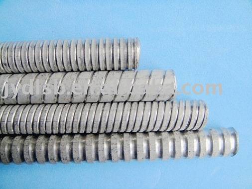

Building on what @anorlunda suggests, how about using a spring and a hollow threaded tube that have the same pitch, with the OD of the cylindrical spring equal to the largest ID of the tube? You can turn the tube to run it farther up the spring, exposing less and less of the spring. The part of the spring in the threaded tube is fixed, and only the part of the spring sticking out the top of the tube is still able to compress.
Can the effective length of the spring change as the stiffness changes?

Great responses, guys. I kinda need the spring to stay relatively long, so the length kinda needs to stay the same. It doesn't have to be a spring. I was thinking of maybe a pully system at first, but then switched to a spring. But maybe a pully system could work? It won't lift automatically, like the spring, but it will assist the lift, which is what I'm looking for. Do you think it would be possible for a pully system to have a switch that can change the difficulty without having to re-string the rope?

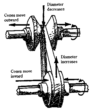

I want to make an object easier to lift or harder to lift by a simple adjustment by the user, while not taking away the range of motion. It's an exercise device, so range of motion is important. You mentioned variable diameter pulleys; what is the purpose of the variable diameter pulley? Those are used in vehicles to change speed? Can that translate to varying lifting difficulty?

OK, that's better.
Consider a simple deraulier gear on a bicycle. Instead of a wheel, think of a rope wrapped around the rear axle with its other end lifting a weight. Then shifting the gears makes lifting the weight easier or harder. It is called simple mechanical advantage. There are countless ways to make it.
Edit: it is also the principle of the lever. To adjust a lever, just move the fulcrum.

Thank you. The derailleur gears are a great suggestion. For my application, I would need to think of a way to change gears without them being in motion. You mentioned a variable diameter pulley. I think that could work. That would be more difficult to construct, and I would need to think of a way to vary the diameter with the rope being in contact with the pulley at all times. Thanks again.
